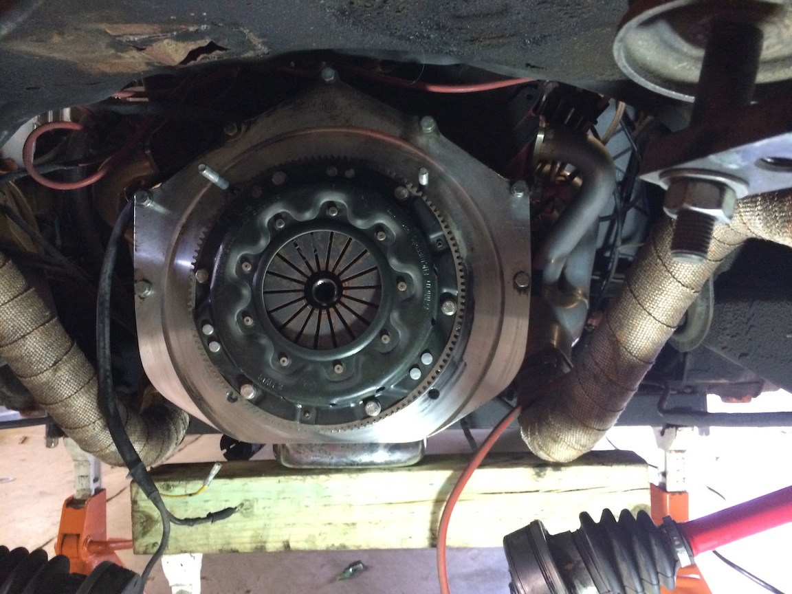

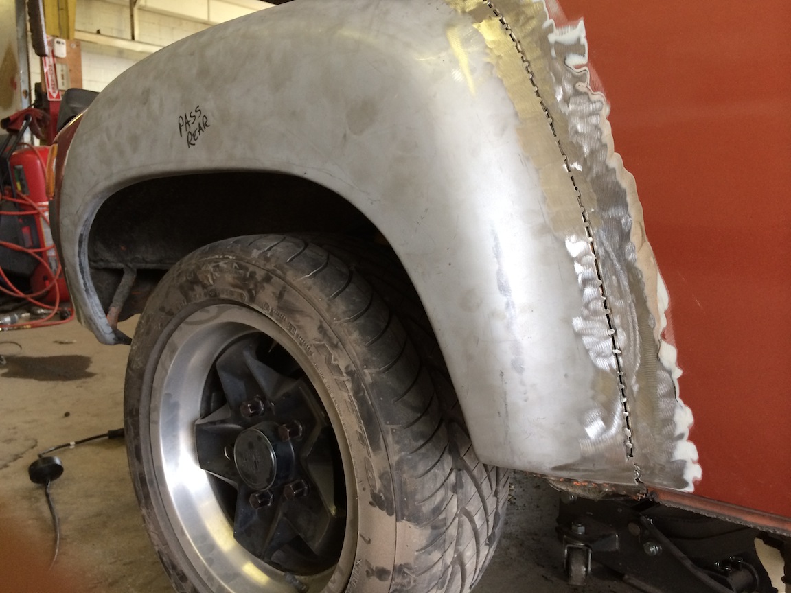

Couple more pics of the flares, and this weekend's trans swap.

CptTripps   Started working on the flares today. Marked everyt...   Sep 14 2013, 04:26 PM
CptTripps   Flares are on...time for some banging and bondo th...   Sep 19 2013, 08:15 AM

jimkelly   I think the consensus will be to fully spot the en...   Sep 22 2013, 06:48 AM
McMark   :o Weld it all.   Sep 22 2013, 07:12 AM
CptTripps   Most of the gaps between welds are under 1/2...   Sep 22 2013, 07:13 AM
CptTripps   Worked on welding up the gaps today. My welder too...   Sep 22 2013, 04:25 PM
jimkelly   what wire are you using? .025 easy grind? gloss s...   Sep 22 2013, 04:34 PM
CptTripps   I was using .23-eg, but honestly, I found .30 easi...   Sep 22 2013, 07:20 PM
bulitt   I'm really not that pleased with the job I...   Sep 23 2013, 06:08 AM
CptTripps   If you are using an extension cord make sure it i...   Sep 23 2013, 06:35 AM

CptTripps   Couple more pics of the flares, and this weekend...   Sep 23 2013, 11:28 AM
