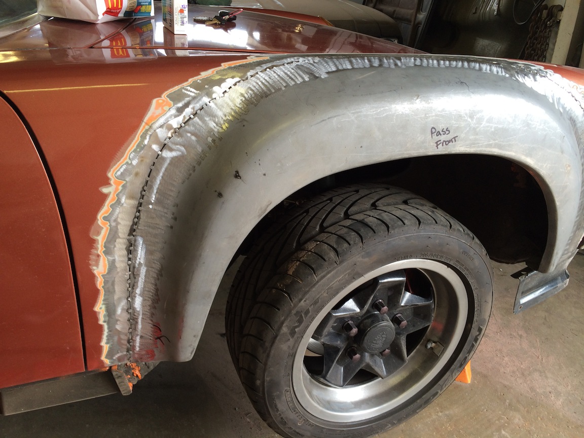

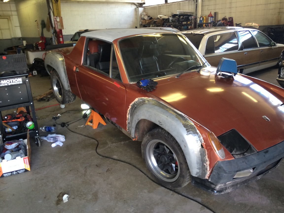

CptTripps   Started working on the flares today. Marked everyt...   Sep 14 2013, 04:26 PM
CptTripps   Flares are on...time for some banging and bondo th...   Sep 19 2013, 08:15 AM
Chris H.   Wow that looks great. Did you do those yourself?   Sep 19 2013, 10:16 AM
bulitt   Flares on 8 days after taking possession. You guy...   Sep 19 2013, 10:47 AM
CptTripps   Flares on 8 days after taking possession. You gu...   Sep 20 2013, 06:59 AM

strawman   As someone who has done the trailing arm reinforce...   Sep 21 2013, 10:44 PM
CptTripps   As someone who has done the trailing arm reinforc...   Sep 23 2013, 06:37 AM
rick 918-S   As someone who has done the trailing arm reinfor...   Sep 23 2013, 08:29 AM
CptTripps   It's all un-sprung weight. The worst kind to ...   Sep 23 2013, 08:39 AM
r_towle   If you can break a pinion gear clean off the shaft...   Sep 21 2013, 11:03 PM
CptTripps   Interesting call on the trailing arms. Hadn't ...   Sep 22 2013, 06:31 AM
jimkelly   I think the consensus will be to fully spot the en...   Sep 22 2013, 06:48 AM
McMark   :o Weld it all.   Sep 22 2013, 07:12 AM
CptTripps   Most of the gaps between welds are under 1/2...   Sep 22 2013, 07:13 AM
CptTripps   Worked on welding up the gaps today. My welder too...   Sep 22 2013, 04:25 PM
jimkelly   what wire are you using? .025 easy grind? gloss s...   Sep 22 2013, 04:34 PM
CptTripps   I was using .23-eg, but honestly, I found .30 easi...   Sep 22 2013, 07:20 PM
bulitt   I'm really not that pleased with the job I...   Sep 23 2013, 06:08 AM
CptTripps   If you are using an extension cord make sure it i...   Sep 23 2013, 06:35 AM

CptTripps   Couple more pics of the flares, and this weekend...   Sep 23 2013, 11:28 AM
pete   Couple more pics of the flares, and this weekend...   Sep 23 2013, 02:36 PM
CptTripps   What are you going to be doing with the pipes and...   Sep 23 2013, 05:38 PM
