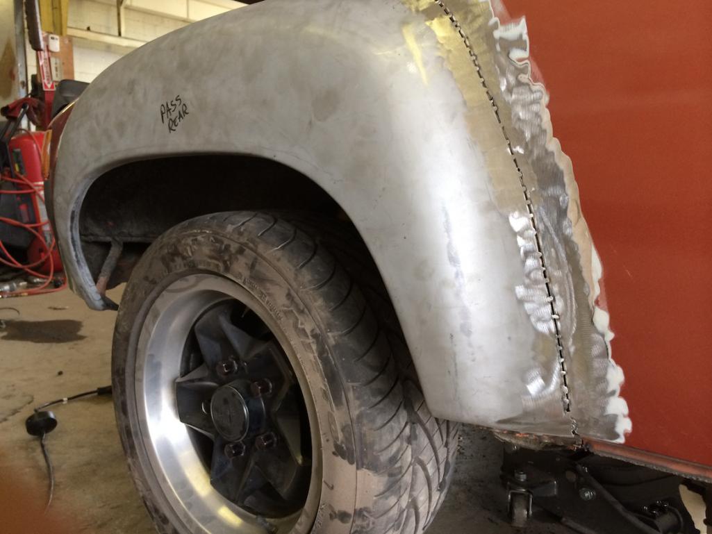

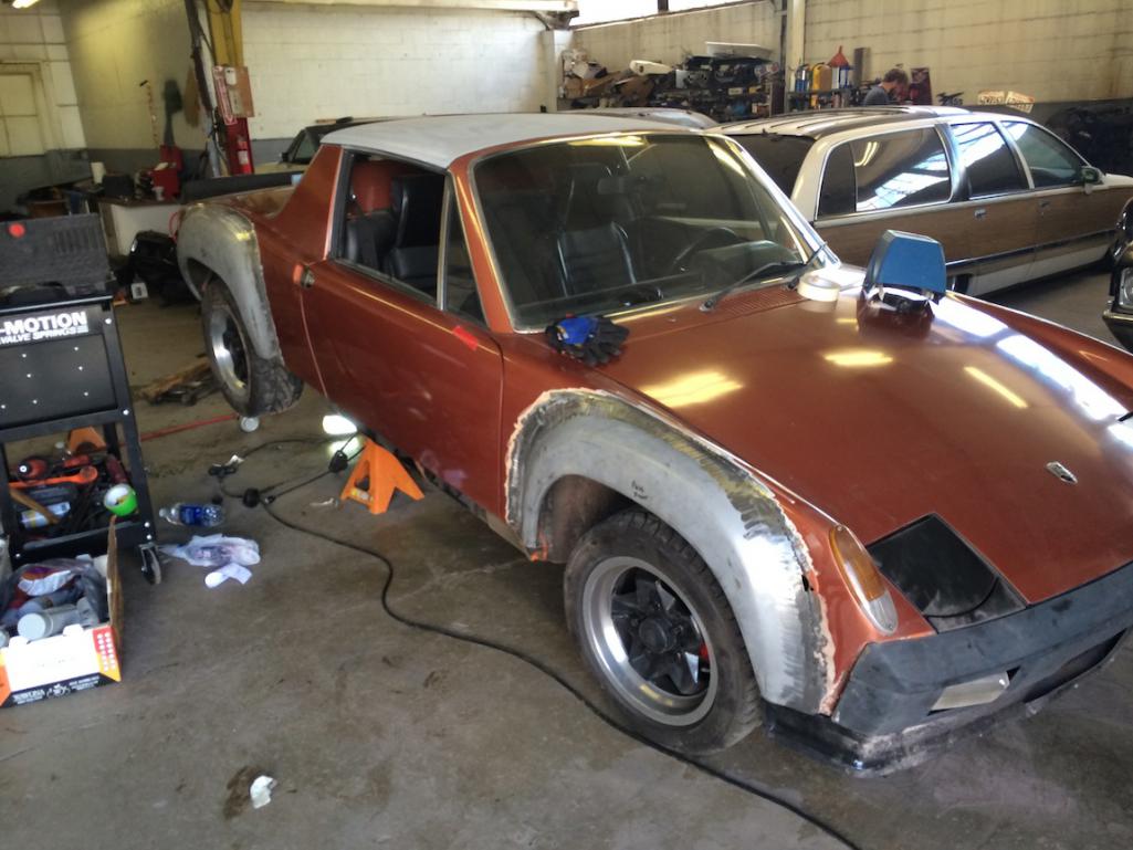

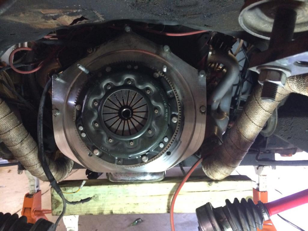

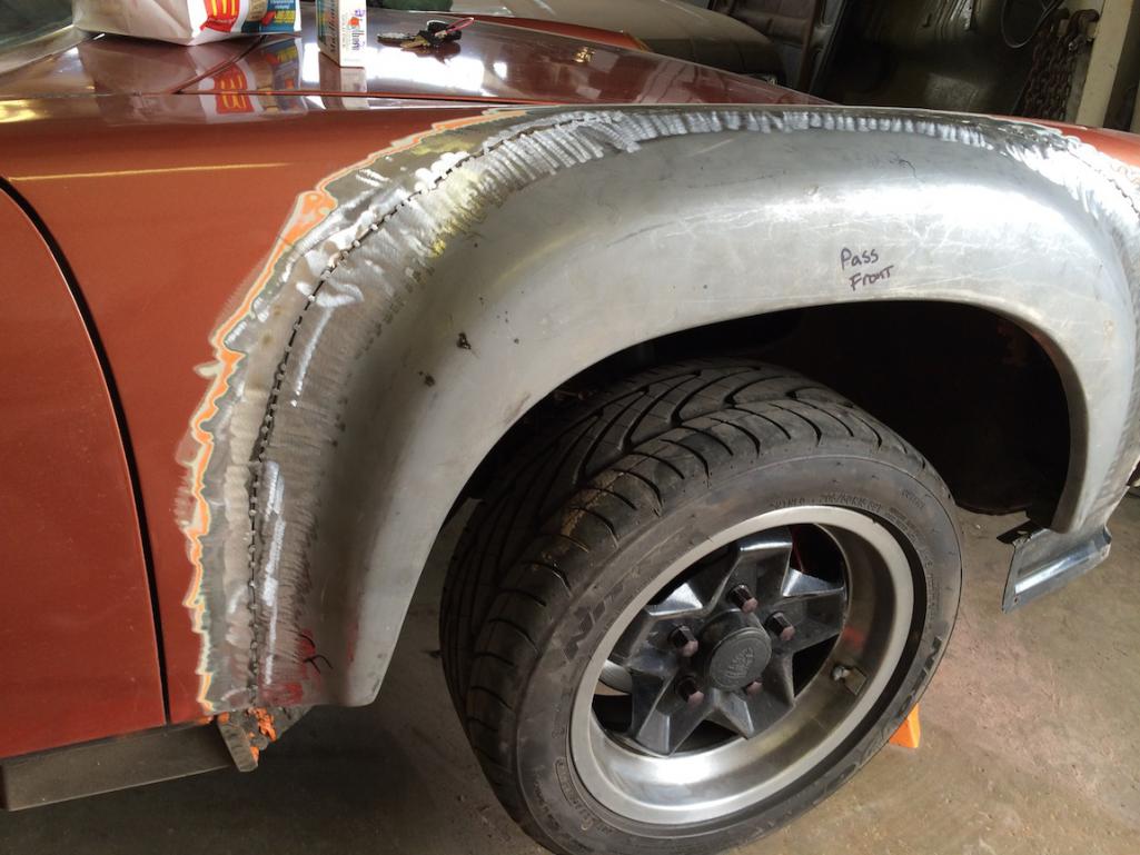

Couple more pics of the flares, and this weekend's trans swap.

What are you going to be doing with the pipes and the rear trans mounts? I'm working on a SBC350 conversion and will be needing soon. (IMG:style_emoticons/default/biggrin.gif)
I'll have the adapter plate and headers for sale shortly. Actually, I'm driving to NJ in 2 weeks, and may be able to bring them out there if we can put a deal together. (IMG:style_emoticons/default/biggrin.gif)

CptTripps   Started working on the flares today. Marked everyt...   Sep 14 2013, 04:26 PM
CptTripps   Flares are on...time for some banging and bondo th...   Sep 19 2013, 08:15 AM
Chris H.   Wow that looks great. Did you do those yourself?   Sep 19 2013, 10:16 AM
bulitt   Flares on 8 days after taking possession. You guy...   Sep 19 2013, 10:47 AM
CptTripps   Flares on 8 days after taking possession. You gu...   Sep 20 2013, 06:59 AM
