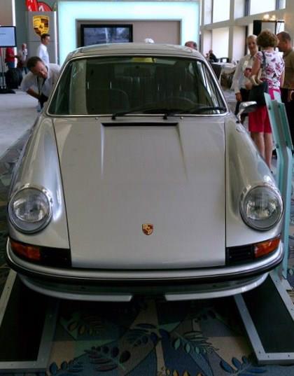

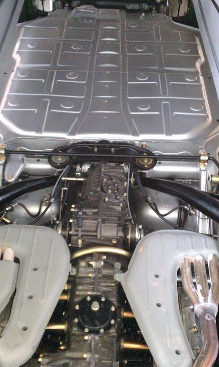

I'm posting some pix of concours cars (including the early 911 that Porsche classic did) so you can see a glimpse the bottom & fender wells..
Look at the 914s in the background, notice the wheel wells.
Again, look at the wheel wells.
Here is a top & bottom picture of the early 911 restored by Porsche..
