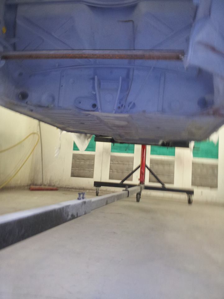

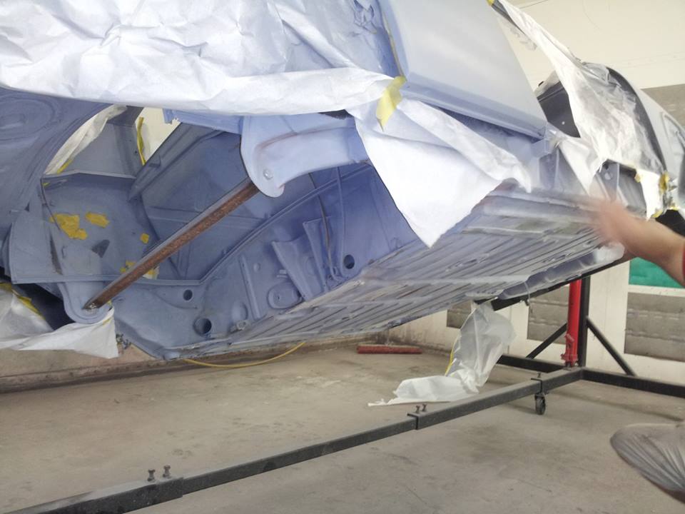

siverson   I just stumbled on these photos so I thought I...   Nov 11 2013, 07:31 PM
McMark   Yellow everywhere is right, except just a dusting....   Nov 11 2013, 07:32 PM
siverson   The yellow car is this one: http://www.ebay.com/i...   Nov 11 2013, 07:33 PM
siverson   And to add my opinion - I really don't mind th...   Nov 11 2013, 07:41 PM
