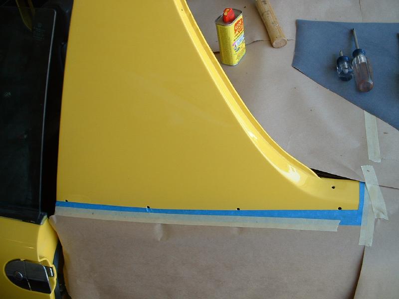

Step 3: Prep
Prep is the most important part to any great job. Once you’ve got everything off you’ll need to prep the car and the surface that you’ll be working on. To prep the car I used the 3M “Blue” tape that is paint friendly on the body and then tapped butcher paper ($15.00 per roll that should last you a lifetime) to mask it off using the regular masking tape. The glue sprays in a definite pattern but it’s best to have everything masked off so you don’t get unwanted overspray. Final prep involves cleaning the surface to be worked and removing all of the old glue (do it damnit… don’t skip this important step.) You’ll especially want to make sure the corners of the roll hoop are clean as the vinyl will have to be bent and somewhat stretched a bit to adhere. Clean, clean, clean. Use the adhesive remover and make sure the entire area is clean. I performed a final wipe down with Acetone. Test fit your vinyl so you know where it’s going during the heat of battle (final installation).
Tape on...
