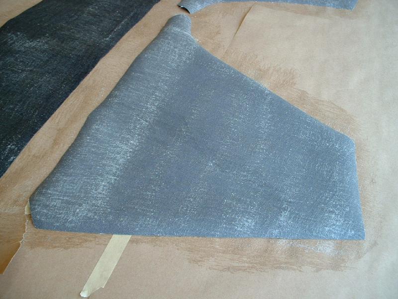

Step 4: Spraying on the Glue
It all goes very fast at this point so you should be well prepared and ready to race the clock. You need to have an area where you can spray both the areas on the car and the backside of the vinyl. I used the butcher paper and covered the rear trunk. It’s an excellent area to lay down the pieces. The glue is sprayed on in two coats on each area (car and vinyl). Each coat goes in a different direction (left to right and then up and down) to ensure even coverage.
