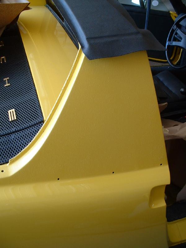

Step 5: Laying Down the Vinyl
First you should remove the paper and tape that you had protecting the car. It will stick to the back of your vinyl making the job impossible. Its job is done now anyway. The vinyl should be applied when each surface is “tacky” to the touch (not dry like most contact adhesives) and this only takes 1-3 minutes. I set the alarm to 3 minutes. You should not let the surface sit for longer than 10 minutes before applying the vinyl… meaning? You’ve got 7 minutes to get the job done. Start with the hoop top. As mentioned earlier I test fit my vinyl before applying the glue. Knowing where I was going I actually laid the top piece over my head and worked my way from the driver’s side to the passenger’s side. Concentrate on starting it straight and concentrate on the flat top surface only. Once it’s down, press it smooth and start rolling those edges down. Hurry, the clock is ticking. Lay on the sidepieces starting in the bottom corner by the handle. There’s a 45 deg. cut there that should straddle the edge of the panel. Hold the back of the vinyl out toward the rear of the car and make sure you will be just covering your mounting holes for the lower trim piece. Smooth each one up and start working the edges over… Whew! The major task is done.
