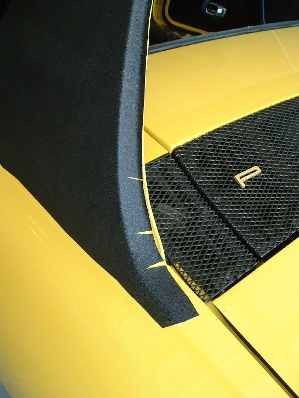

I searched the site for a step-by-step on installing sail panel vinyl. I found people who had done it but no detailed instructions to give you an idea of what’s involved and/or give you the tools to carry on for yourself. With cars that are 28-34 years old, I’m sure there’s more than a few of us driving around out there with peeling, unsightly sail panel vinyl. This is a “Big” job when done right. You’ll have a good portion of your car torn apart. Plan on a weekend where you prep one day and assemble the next. Here’s what it will take to get yours back to new.

Slices needed to allow the vinyl to bend...

Eric_Shea   Slices needed to allow the vinyl to bend...   Jul 21 2004, 04:52 PM
