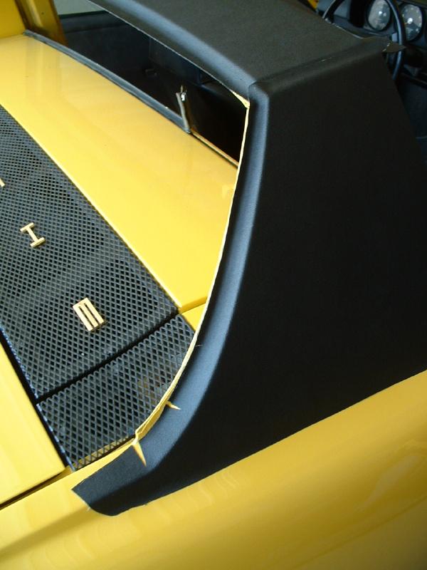

I searched the site for a step-by-step on installing sail panel vinyl. I found people who had done it but no detailed instructions to give you an idea of what’s involved and/or give you the tools to carry on for yourself. With cars that are 28-34 years old, I’m sure there’s more than a few of us driving around out there with peeling, unsightly sail panel vinyl. This is a “Big” job when done right. You’ll have a good portion of your car torn apart. Plan on a weekend where you prep one day and assemble the next. Here’s what it will take to get yours back to new.

You’ll obviously need to take off all the trim pieces before digging into this task. Remove your (cars) top and start with the large pieces that trim the back of each sail panel. You may want to remove the rear wheel to access the 8mm nut underneath the car. This holds a clip that holds the trim piece at the base. There is one other mount and that’s a Phillips screw. Next would be the front side of the sail panel where you’ll need to remove the rubber weather strip at the back of the door and then remove the Phillips screws holding the mounting track. Use the putty knife to get under the mounting track trim piece as they are glued on with a nice sticky tar substance. I’ll let you work your way through the remaining pieces (basically un-screw, un-screw, un-screw…)

Eric_Shea   Step 5: Laying Down the Vinyl First you should re...   Jul 21 2004, 04:50 PM
Eric_Shea   Top and Side.   Jul 21 2004, 04:51 PM
Eric_Shea   Slices needed to allow the vinyl to bend...   Jul 21 2004, 04:52 PM
Eric_Shea   Other Side...   Jul 21 2004, 04:53 PM
Eric_Shea   Step 6: Trimming the Vinyl Next you simply trim o...   Jul 21 2004, 04:54 PM
Eric_Shea   Trimmed out...   Jul 21 2004, 04:55 PM
Eric_Shea   Test fit the trim pieces to gauge final cuts.   Jul 21 2004, 04:56 PM
Eric_Shea   Here's a shot of the final bottom area that ne...   Jul 21 2004, 04:57 PM
Eric_Shea   Trimmed...   Jul 21 2004, 04:58 PM
Eric_Shea   Step 7: Put it all Back Together Not much I can t...   Jul 21 2004, 05:00 PM
