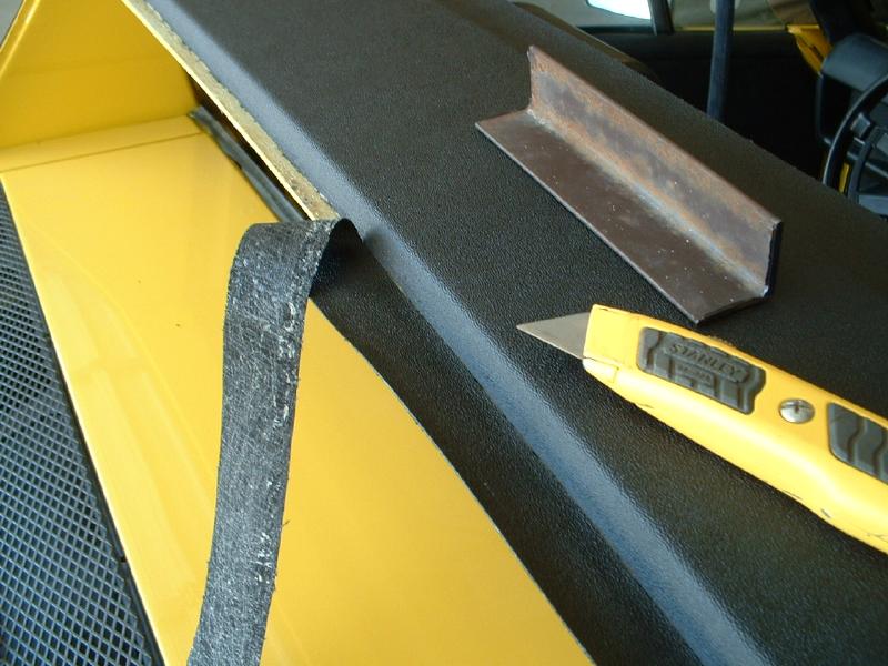

Step 6: Trimming the Vinyl
Next you simply trim off any excess vinyl. Starting with the top piece. The factory simply ran a blade along the base of each bend on the front and back of the hoop. I used a piece of angle iron to press the vinyl into these dips in the metal. This little homemade tool worked great. If you decide to use this make sure there are no sharp edges that would mar the vinyl. A word about blades; KEEP THEM SHARP. By cutting and dragging across metal your blade will dull instantly. Feel free to change them after each long cut or whenever they begin to show a sign of dulling. My first job was hanging wallpaper professionally (years ago) and a sharp blade is one of the most important things when working with vinyl. Trim the sides in a similar manner leaving the bottom for last. When trimming the bottom, you’ll want to test fit the bottom trim piece (without the clips in it) and draw a line on the vinyl in pencil. The line should be made “under” the trim piece on a portion of the vinyl that will be trimmed anyway. Remove the trim piece and cut roughly 1/8” of an inch above your newly drawn line. This is “very” tricky and requires a patient hand and an extremely new blade… better yet, a very sharp, single-edged razor blade. You want to try to cut the vinyl only and not dig into the paint. As you know, water can gather here and any slice through the paint and down to the bare metal will… rust.
