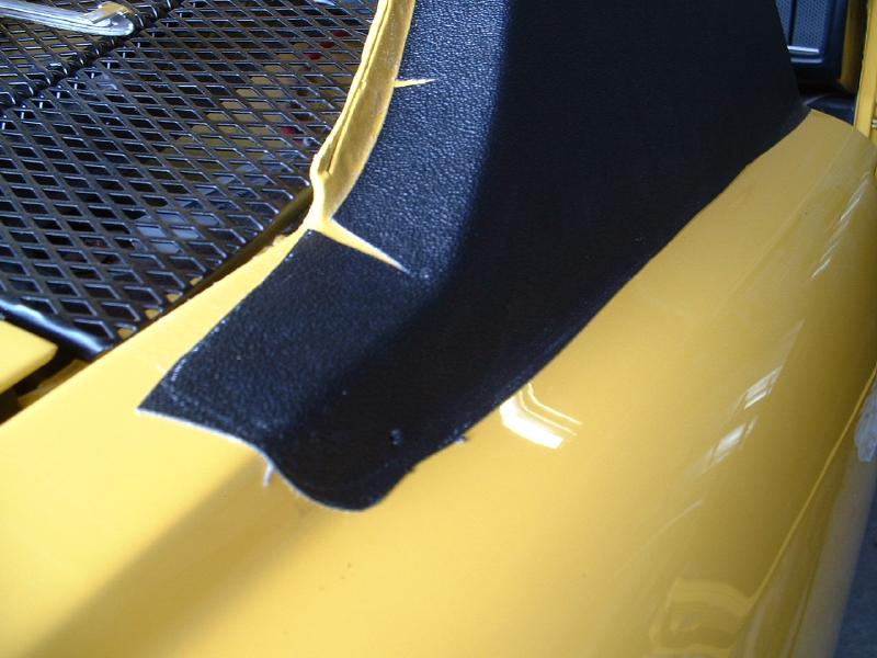

Here's a shot of the final bottom area that needs to be cut. You can barely make out the pencil lines.

Eric_Shea   Here's a shot of the final bottom area that ne...   Jul 21 2004, 04:57 PM
