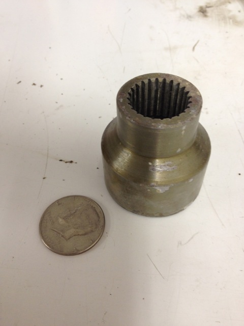

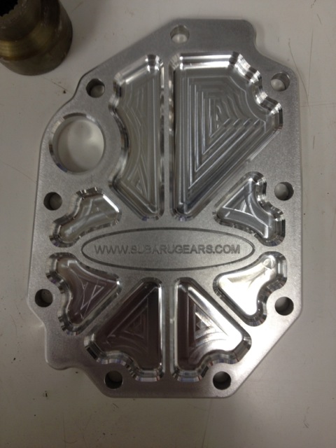

Keep it up, Subaru Gears is pretty fast at shipping their stuff over seas. My little mail fairy dropped these off today. Ordered them Friday or Saturday, I can't remember. Man thats smaller than I thought it would be.
And this.
Way to keep plugging away (IMG:style_emoticons/default/aktion035.gif) what are you using from Summit for the pedal cluster?
