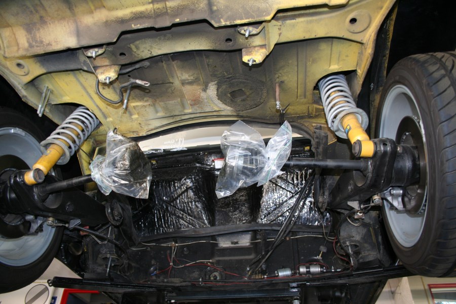

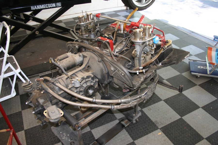

OMG, I went to bed last night and the Leprechauns must have showed up while I was sleeping and look what they did! So now what else should I do "while I'm in there"? Everything in there is at least 10 years old. I'm thinking of replacing all the cables and I'll have to replace the engine tin rubber seals as they were somewhat damaged when the car was raised off the engine. All the rubber fuel lines will be changed out to the new plastic lined ones. New fuel filter. What else besides general cleaning and re-painting? The engine has about 30,000miles on it. If I have the bad head done, does anyone recommend doing the other one as well or "if it aint broke, don't fix it"?

Elliot Cannon   Mid-rise lift makes a good work bench.   Sep 27 2013, 07:03 PM
Elliot Cannon   I hope I remember how all this shit goes back toge...   Sep 27 2013, 07:05 PM
Elliot Cannon   Both the rocker arm assemblies are totally clean. ...   Sep 27 2013, 07:07 PM
