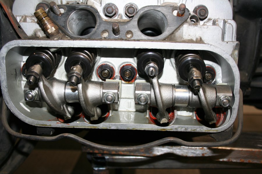

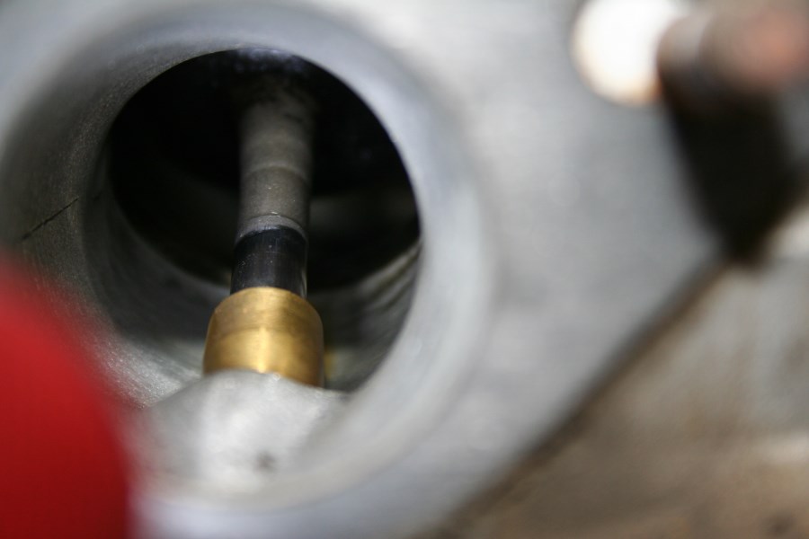

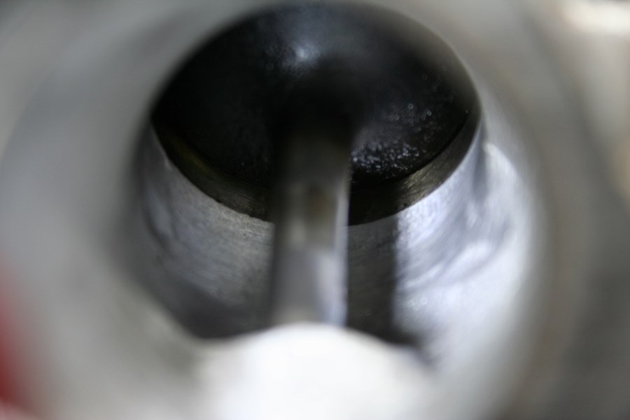

These valve guides just don't look right and maybe someone can help explain what I'm looking at. Three of the intake valves have what I think is a brass valve guide showing? It shows weather the valves are open or closed. One of the valves doesn't show anything as you can see from the pics. Does this mean the valve guides have come loose? The last picture shows the rockers looking pretty clean. Anyway, it looks like both heads will come off.

euro911   I would go through both heads. It will help to ass...   Sep 27 2013, 01:37 AM
SLITS   Most engines that use guides, the guide for the va...   Sep 27 2013, 06:28 AM
bulitt   Slits has it. The guide has moved in the head. Eit...   Sep 27 2013, 06:45 AM

lsintampa   IDK, If the valve guide were leaking, it would s...   Sep 27 2013, 10:26 AM
stugray   If the valve guide is loose and leaking, that wi...   Sep 27 2013, 11:04 AM

Elliot Cannon   Both the rocker arm assemblies are totally clean. ...   Sep 27 2013, 07:07 PM

r_towle   Can you see the valve guide on the vale in questio...   Sep 30 2013, 09:23 PM
Elliot Cannon   It has dual springs and I can't see anything.   Sep 30 2013, 09:25 PM
