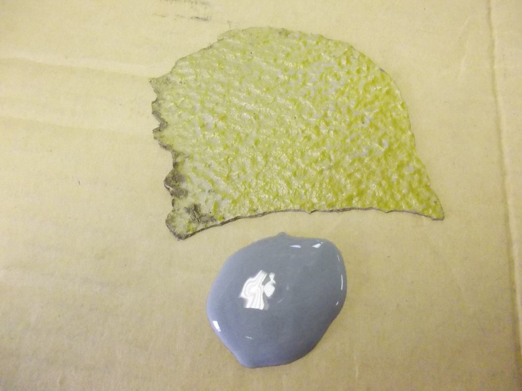

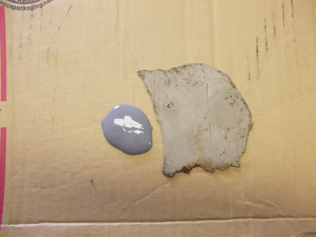

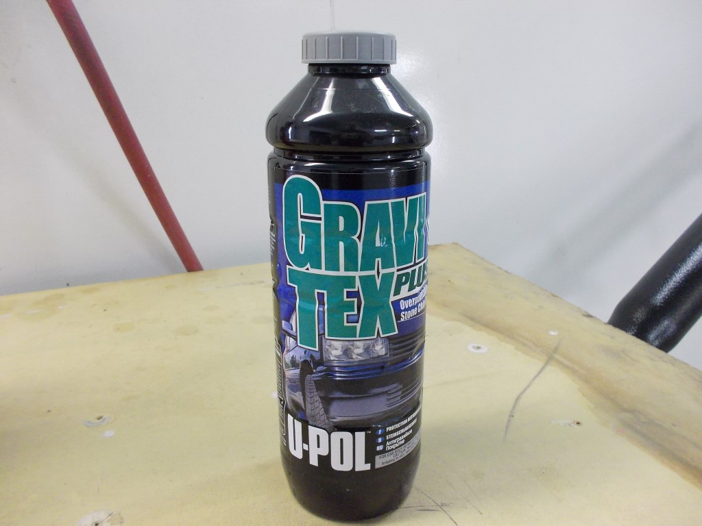

Gun, new coating ( I have yet to try either ) and a piece of original undercoating from a 6.

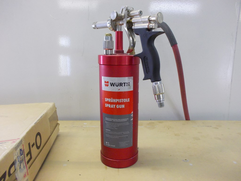

rudedude   Wurth has a special gun for their product that wor...   Sep 21 2013, 08:01 AM
McMark   I have this seam sealer gun from Wurth and haven...   Sep 21 2013, 09:46 AM

scotty b   Gun, new coating ( I have yet to try either ) and ...   Sep 27 2013, 06:17 PM
McMark   I have that gun as well. Sprayed SKS Stoneguard w...   Sep 27 2013, 07:37 PM
scotty b   I have that gun as well. Sprayed SKS Stoneguard ...   Sep 27 2013, 08:10 PM

rudedude   That's the gun I used restoring my 1970 911S t...   Sep 27 2013, 07:45 PM
McMark   Previously I tried: 0893228 SPRAY SEAMSEALER GREY...   Sep 27 2013, 09:30 PM

scotty b   RIGHT : No idea what the pressure was but it was ...   Sep 28 2013, 06:16 PM
sixnotfour   Nice Scat !!!   Sep 28 2013, 06:32 PM
McMark   That's my complete setup as well. :thumbsup...   Sep 28 2013, 06:52 PM
