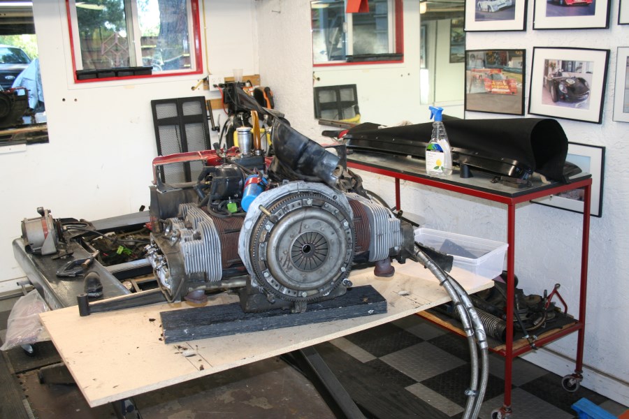

Elliot Cannon   Mid-rise lift makes a good work bench.   Sep 27 2013, 07:03 PM
Elliot Cannon   I hope I remember how all this shit goes back toge...   Sep 27 2013, 07:05 PM
Elliot Cannon   Both the rocker arm assemblies are totally clean. ...   Sep 27 2013, 07:07 PM
