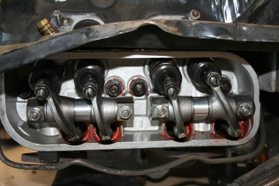

Could this leak be coming from a crack in the head at the valve guide?

Both the rocker arm assemblies are totally clean. I thought there would be more gunk in there. (IMG:style_emoticons/default/WTF.gif) You know, besides all that orange shit. (IMG:style_emoticons/default/lol-2.gif)

euro911   I would go through both heads. It will help to ass...   Sep 27 2013, 01:37 AM
SLITS   Most engines that use guides, the guide for the va...   Sep 27 2013, 06:28 AM
bulitt   Slits has it. The guide has moved in the head. Eit...   Sep 27 2013, 06:45 AM
rhodyguy   remove, straighten, and 'pretty up' the en...   Sep 27 2013, 07:14 AM
lsintampa   IDK, If the valve guide were leaking, it would s...   Sep 27 2013, 10:26 AM
stugray   If the valve guide is loose and leaking, that wi...   Sep 27 2013, 11:04 AM
914_teener   I am with Mark......, Elliot.... I'd do both ...   Sep 27 2013, 12:04 PM
Elliot Cannon   I am with Mark......, Elliot.... I'd do both...   Sep 27 2013, 12:18 PM
SLITS   You two should get a room. Can I pick on you now ...   Sep 27 2013, 01:31 PM
Elliot Cannon   You two should get a room. Can I pick on you now...   Sep 27 2013, 07:02 PM
r_towle   It looks like it moved. I would re-ring it, but th...   Sep 27 2013, 02:01 PM
