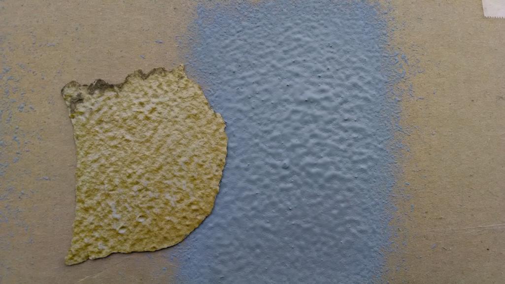

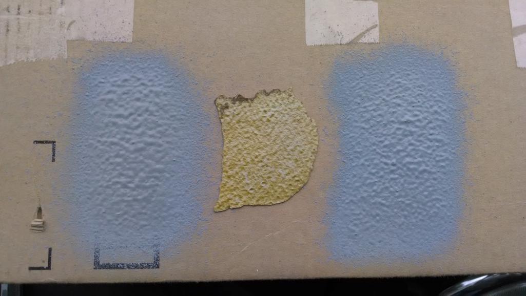

No idea what the pressure was but it was LOW. Fluid almost all the way open, ( just before getting a solid stream ). You have to get kind of of close, and move slow, but it gets the result. I will also add this gun had set long enough the old SKS had started to set up so there are some hard pieces in it. I'll also add this was on a vertical surface. Horizontal would be a bit tricky as this stuff is on the thin side and will want to droop
LEFT :
Higher pressure, further distance, got too smooth. Any more fluid openeing ( I think this is actually closing the orifice, despite the knob coming out ) and it gets a really small grainy pattern

scotty b   RIGHT : No idea what the pressure was but it was ...   Sep 28 2013, 06:16 PM
