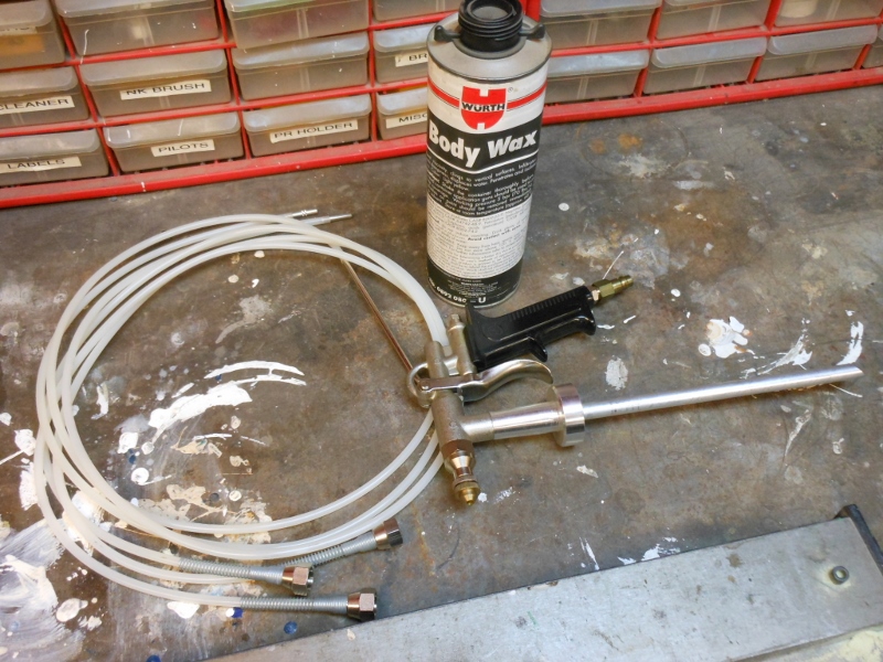

Scotty B's is nicer and has 10 HP more due to the red anodizing. I'm jealous!
The multi sprayer is cool because it also has the fittings and extension hoses for cavity wax. I like it due to its flexibility.
Wurth makes a Shutz gun for use with the larger bottles, Waxing external panels and Stone Guard like VW does on current models. I have one but have never used it for that purpose. It does have a high output adjustable nozzle which may work better at lower pressure for that pebble peel look. Have to give it a try to see if it has other than Shutz use

scotty b   Gun, new coating ( I have yet to try either ) and ...   Sep 27 2013, 06:17 PM
McMark   I have that gun as well. Sprayed SKS Stoneguard w...   Sep 27 2013, 07:37 PM
scotty b   I have that gun as well. Sprayed SKS Stoneguard ...   Sep 27 2013, 08:10 PM

scotty b   RIGHT : No idea what the pressure was but it was ...   Sep 28 2013, 06:16 PM
sixnotfour   Nice Scat !!!   Sep 28 2013, 06:32 PM
McMark   That's my complete setup as well. :thumbsup...   Sep 28 2013, 06:52 PM
