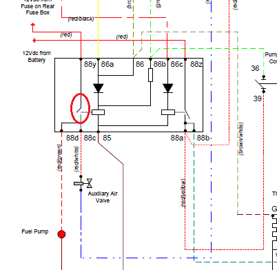

Glad to hear this, but we still have to address a few house keeping issues. The CHT sensor, did you ever recheck this? Either pin 13 to ground with your multimeter, or by disconnecting the CHT connector and checking the resistance there? I personally would like to know if a failed CHT sensor would keep a Ljet from firing up, just for my own knowledge.
Now going back to post #10. I had you check the voltage at the dual relay for pin 88y, and you reported back with 11volts (battery voltage). So far so good, but then I had you check pin 88d and you reported back with 8-9 volts. This part isn't so good, which shows a drop across the contact points inside the dual relay. See red circle in the attached picture
To put this to bed, lets do one more test. With the car off (ignition off) set your multimeter for DC and put the red meter lead on 88y and the black meter lead on pin 88d. You should see 12vdc or whatever the current battery voltage is. Now, go ahead and start the car. With the car running, you should see 0vdc on the meter. If your meter shows anything higher than 0.5vdc, it will be imperative that you replace the dual relay soon, as it could leave you stranded on some desert highway.
