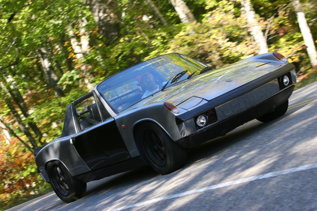

hard to tell exactly what color this car is, but seems a version of grey.
(IMG:http://www.914world.com/bbs2/uploads/post-9028-1381179892_thumb.jpg)
