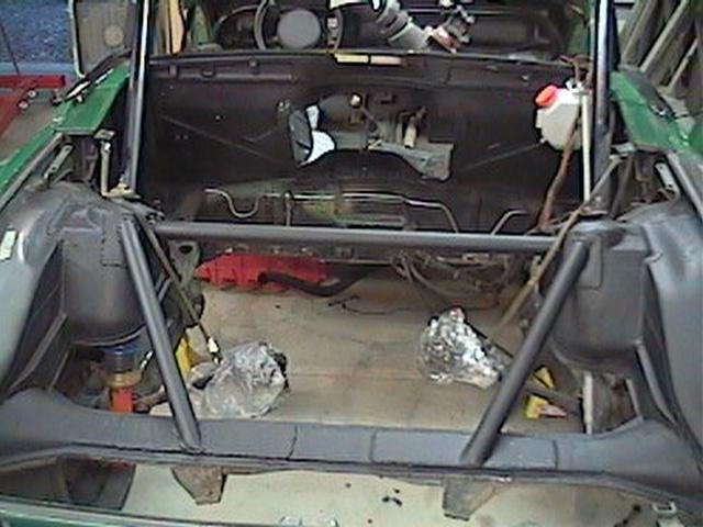

Mike T   Maybe like this?   Jul 23 2004, 08:28 AM

Mueller   andrew, you have to be careful strengthening the c...   Jul 23 2004, 10:45 AM

Mike T   My car is an autocross car. No street. So the brac...   Jul 23 2004, 12:07 PM
