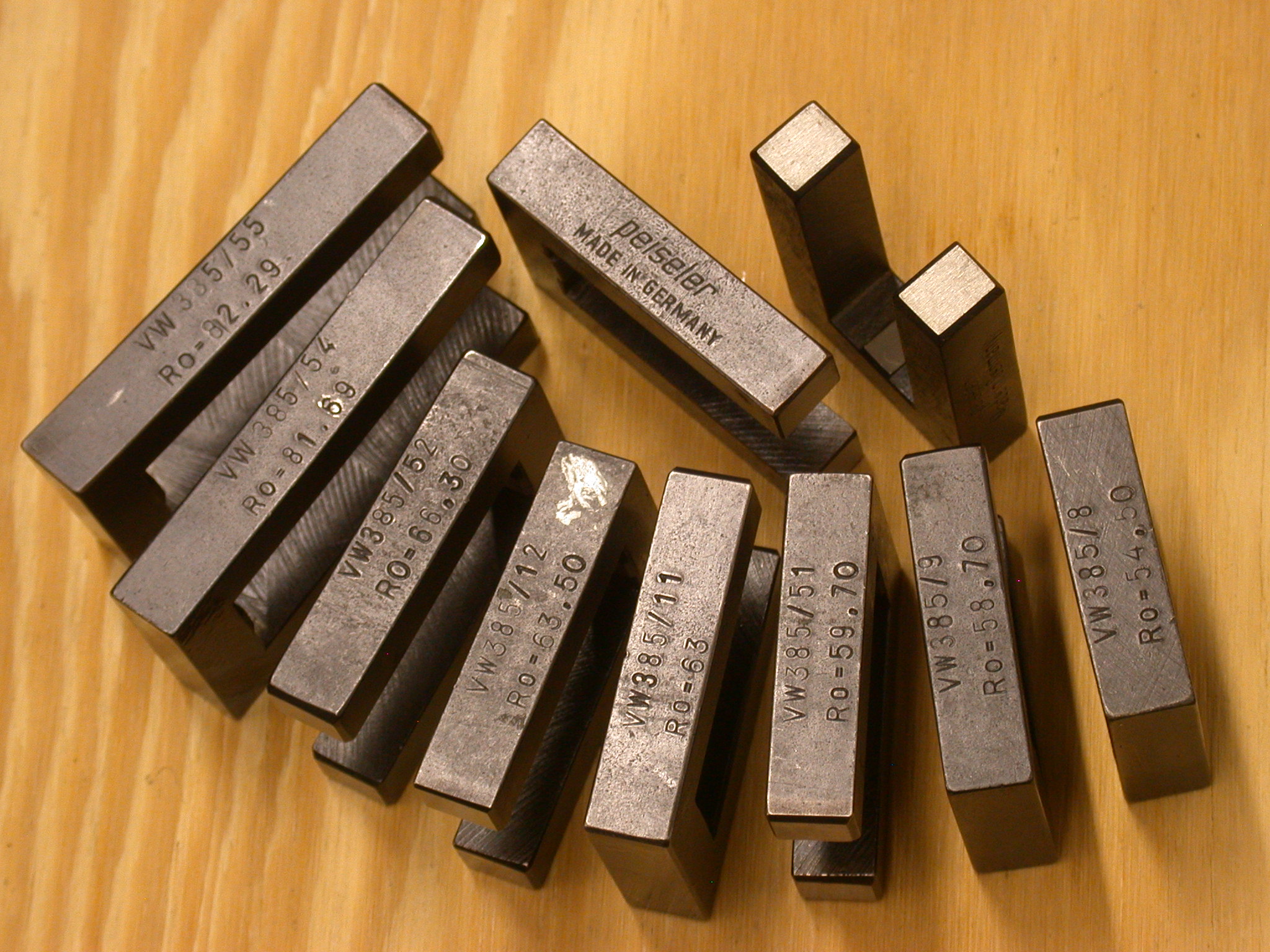

John,
I have more than one bar, but keep the small items in one case.
If I part with any fixed gauges, the rest will fall over like dominoes.
Baum or Zelenda may still have some.
Photo below of Porsche sizes through 915/930.
The 901/911/914 gauge is VW385/12, Ro=63.50mm.
Smaller gauges are 924/944/944 Turbo and 905/925 Sportomatic sizes...
Jon B.

Jon B   John, I have more than one bar, but keep the smal...   Oct 9 2013, 10:00 PM
