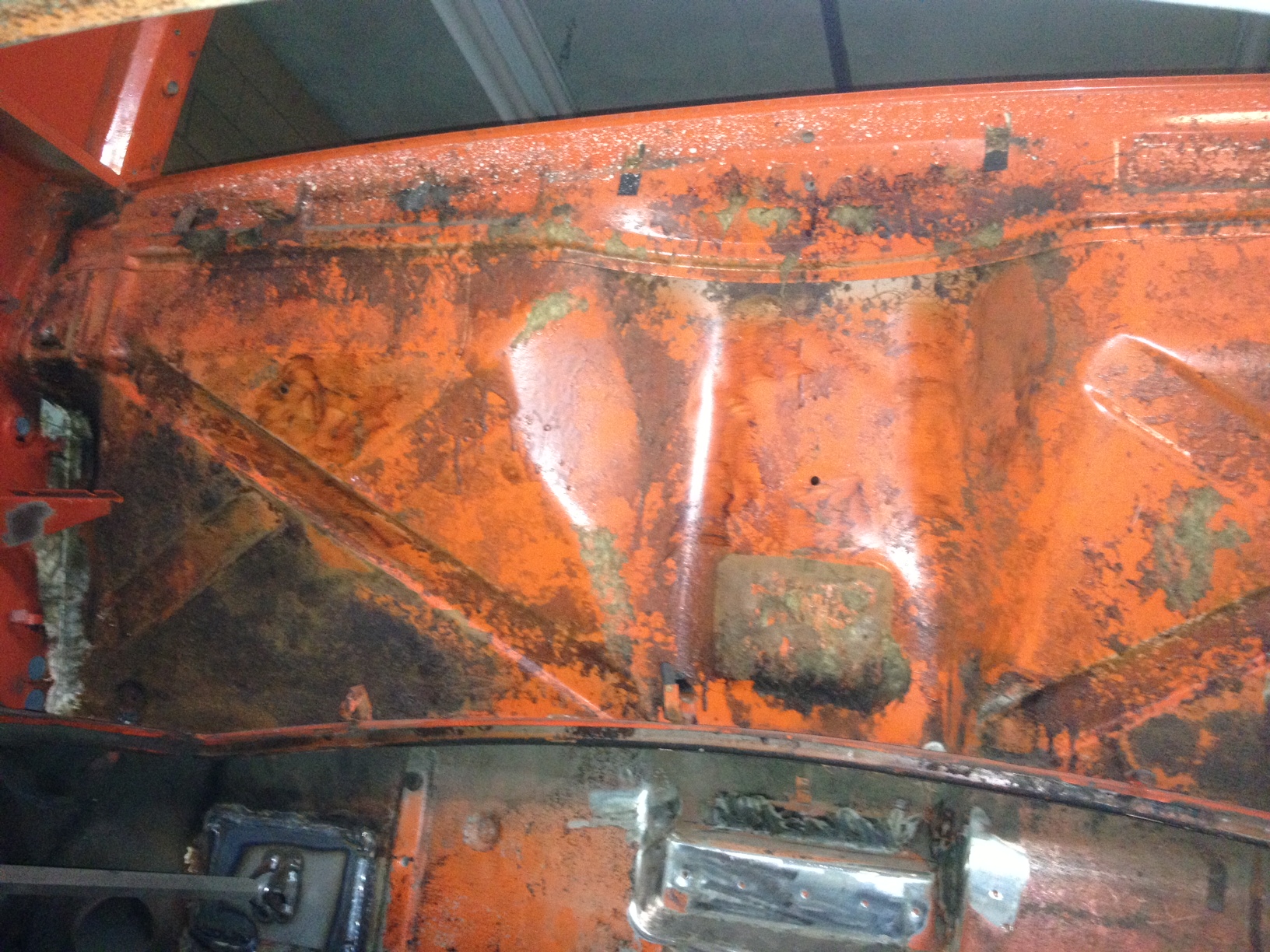

post Oct 11 2013, 05:30 AM
Posts: 470
Joined: 17-January 05
From: Canton, OH
Member No.: 3,459
This is a picture of the upper section of the firewall that has the rust on it, especially in both lower corner sections.
This is the piece that I am going to use to replace the bad section which has just been blasted to clean it up.
I am hoping that someone has replaced this panel before and can give me some advice on how to do it.
Jeff B
