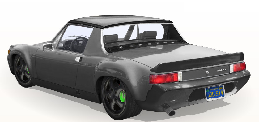

I'm back in the mix, and getting ready for another 914 restoration. Not sure this will play out as well as it did Last Time, but we'll give her a go and see what I can come up with!
After I find the right starting-point, here's what I've been dreaming of doing to it.
Subaru EJ20 Turbo 4 engine & Trans. (250-275hp target)
Steel flares
5-bolt hubs
Boxster brakes
Stiffen up the body. (MAYBE a roll-bar.)
Satin silver paint, blacked-out chrome, black satin rims...with colorful calipers.

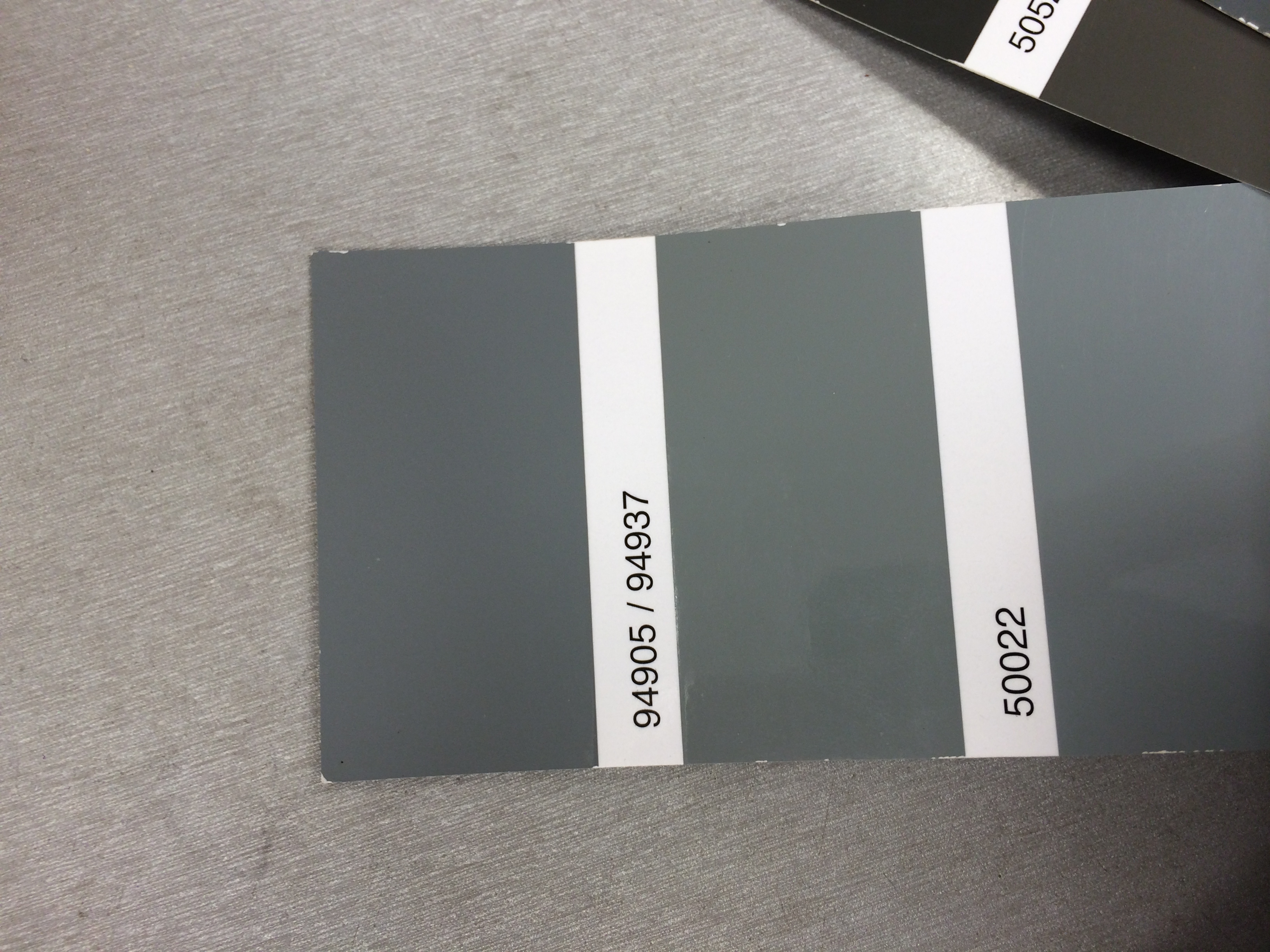

I've been out of town for the last week or so in NYC and Las Vegas. Got home today, and plan on spending this weekend working on clearing the rest of the garage out so I can get her up on jack stands and start stripping the tub.
I settled on my paint color last week. I was originally going to do the Porsche Sport Classic Gray but ended up going a little darker than that. I didn't want it to be confused with Primer at all...and think this look will be right in line with what I'm going for.
So...I went to Sherwin Williams and bought the whole shooting match. Etching primer, 2K primer, and the basecoat (94937). The shop that I'll have the last coat, along with the clear done at is a SW shop, and SW is a client of my company, so I got a pretty good deal on everything.
Here's what the car SHOULD look like when I'm done. At least that's what I'm shooting for.
