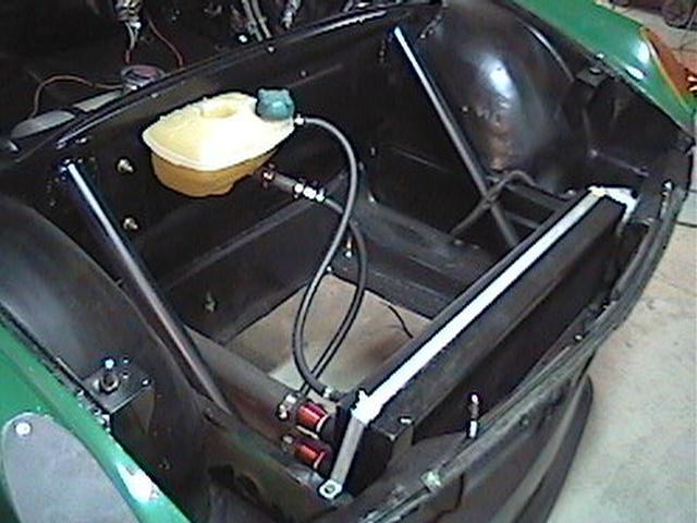

My car is an autocross car. No street. So the bracing is a bit extreme for what you would need on a street car.
Here is the front bracing along with the radiator setup.
If you want to destroke your engine the 327 crank would be a good cost effective choice. The 3.25" stroke pistons are available cheap from Summit or other suppliers.
If you wanted to go with a 3.00" stroke and make a 302 you'd have to find a large journal crank and that would cost more as would the pistons.
