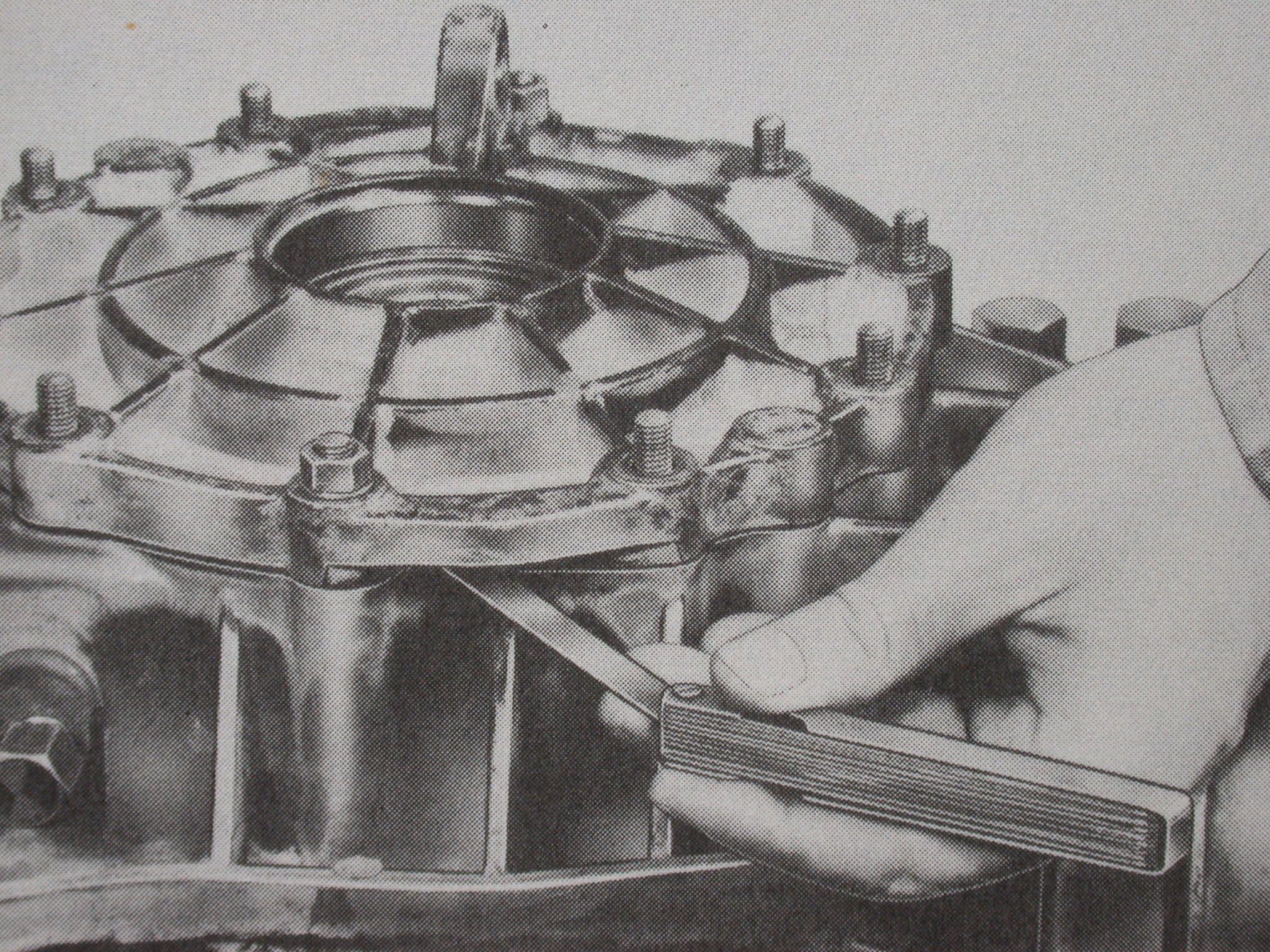

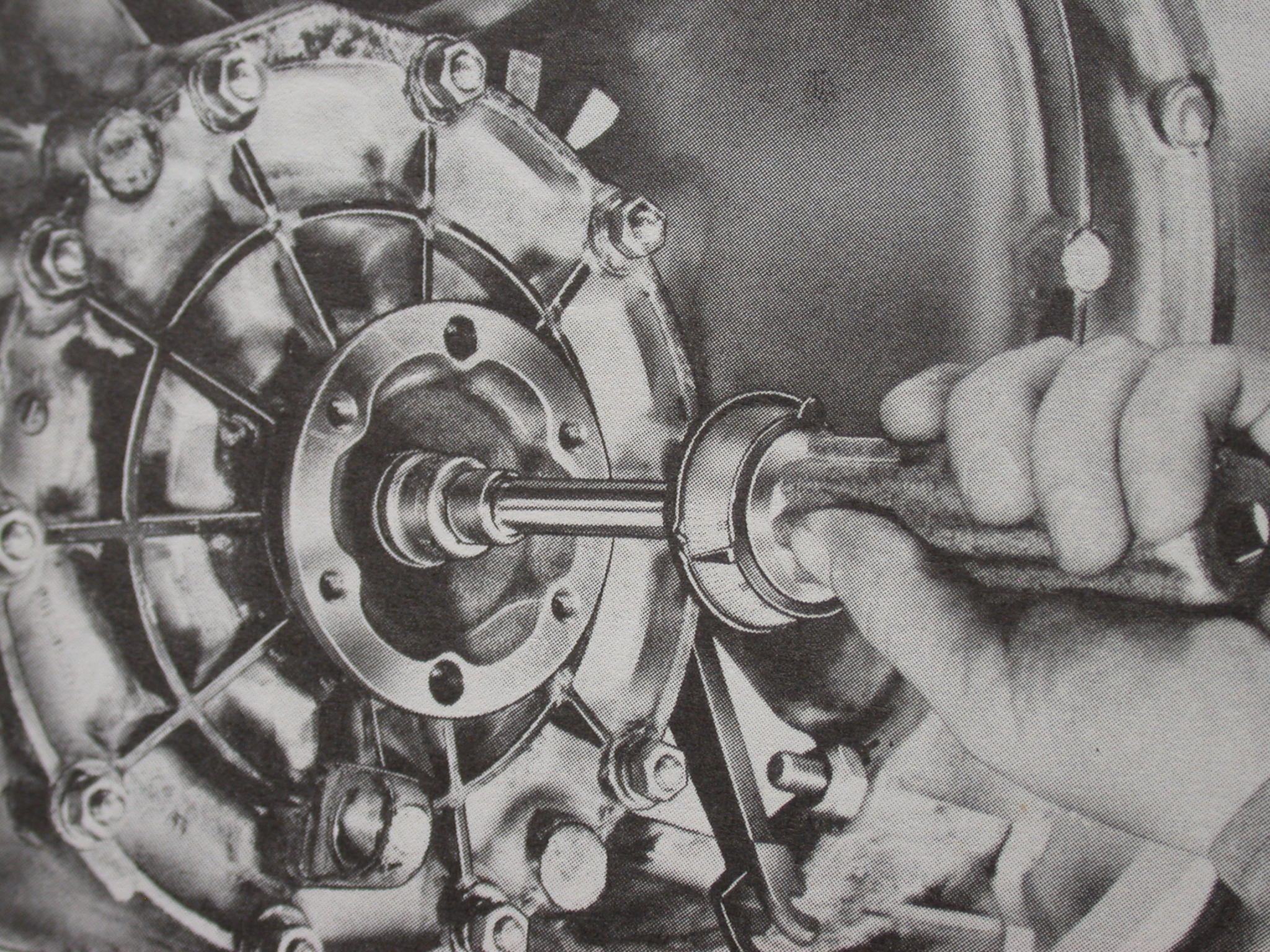

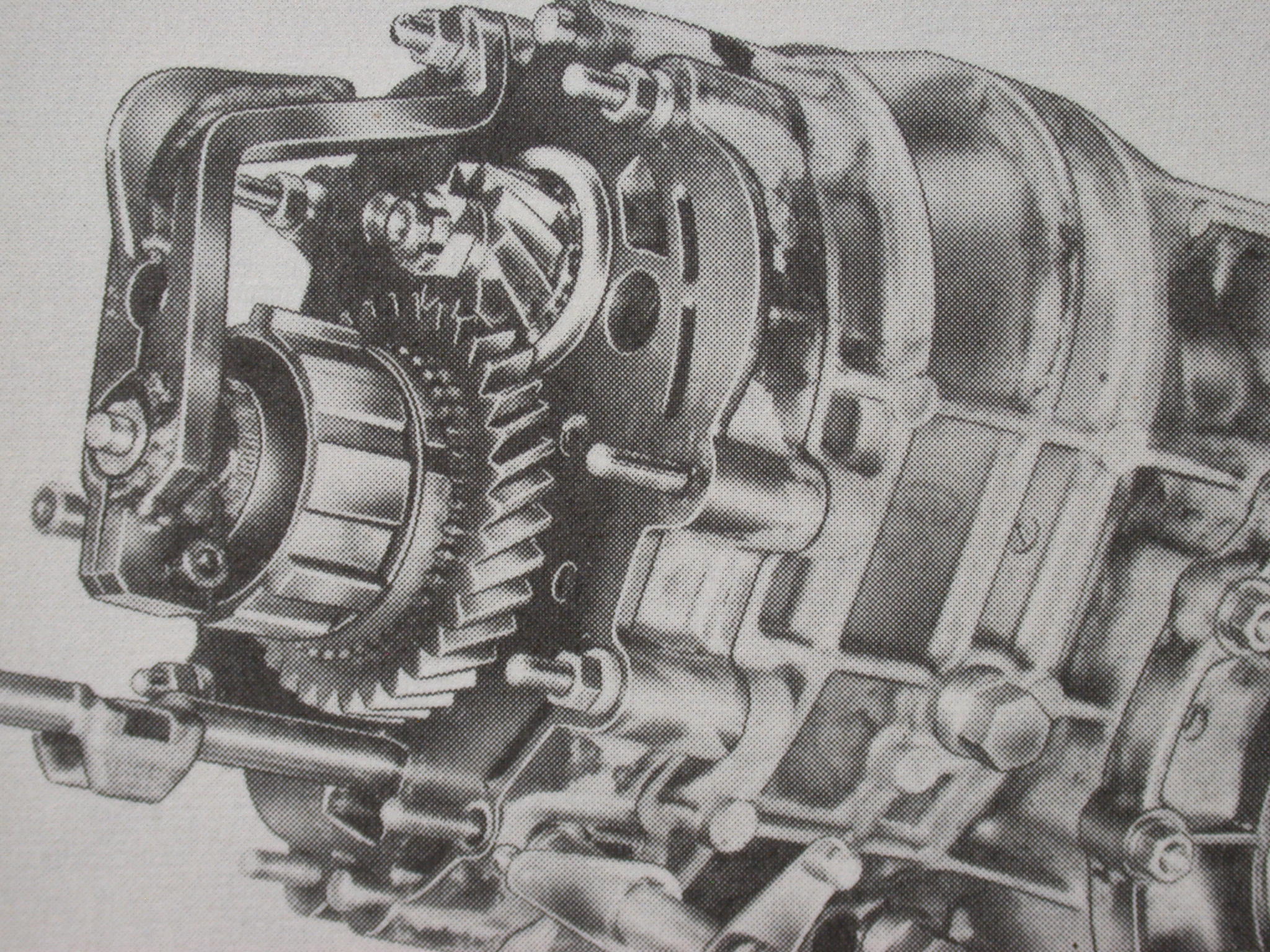

914 Transmission
Measuring differential bearing preload
Measuring ring gear backlash
Adjustments made using differential shims
Factory shim range: 0.25mm shim; 2.4mm to 3.7mm shims
Photos, specs from factory 914 Workshop Manual
Nominal value approx 0.15mm (0.006")

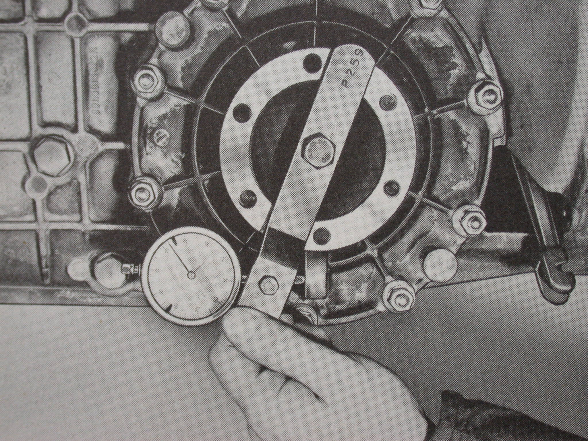

Measuring differential bearing preload (drag), pinion disengaged
SKF Bearings 25-35 cmkp (22-30 lbs. in.)
FAG Bearings 40-65 cmkp (35-57 lbs. in.)
Locking pinion shaft with P259 clamp
Backlash range 0.12mm to 0.18mm (0.005" to 0.007")
Measured 4 times at 90 degree intervals
