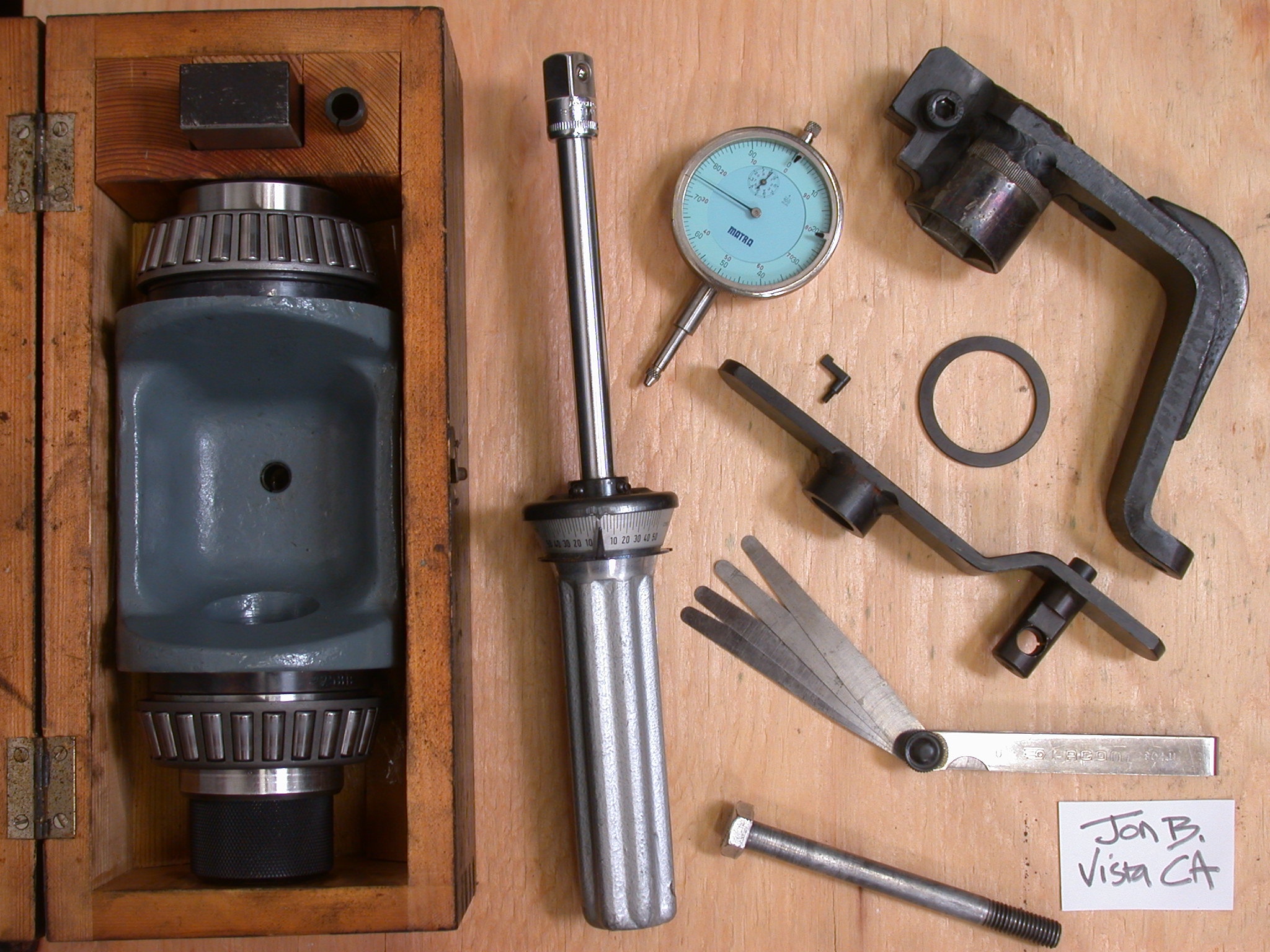

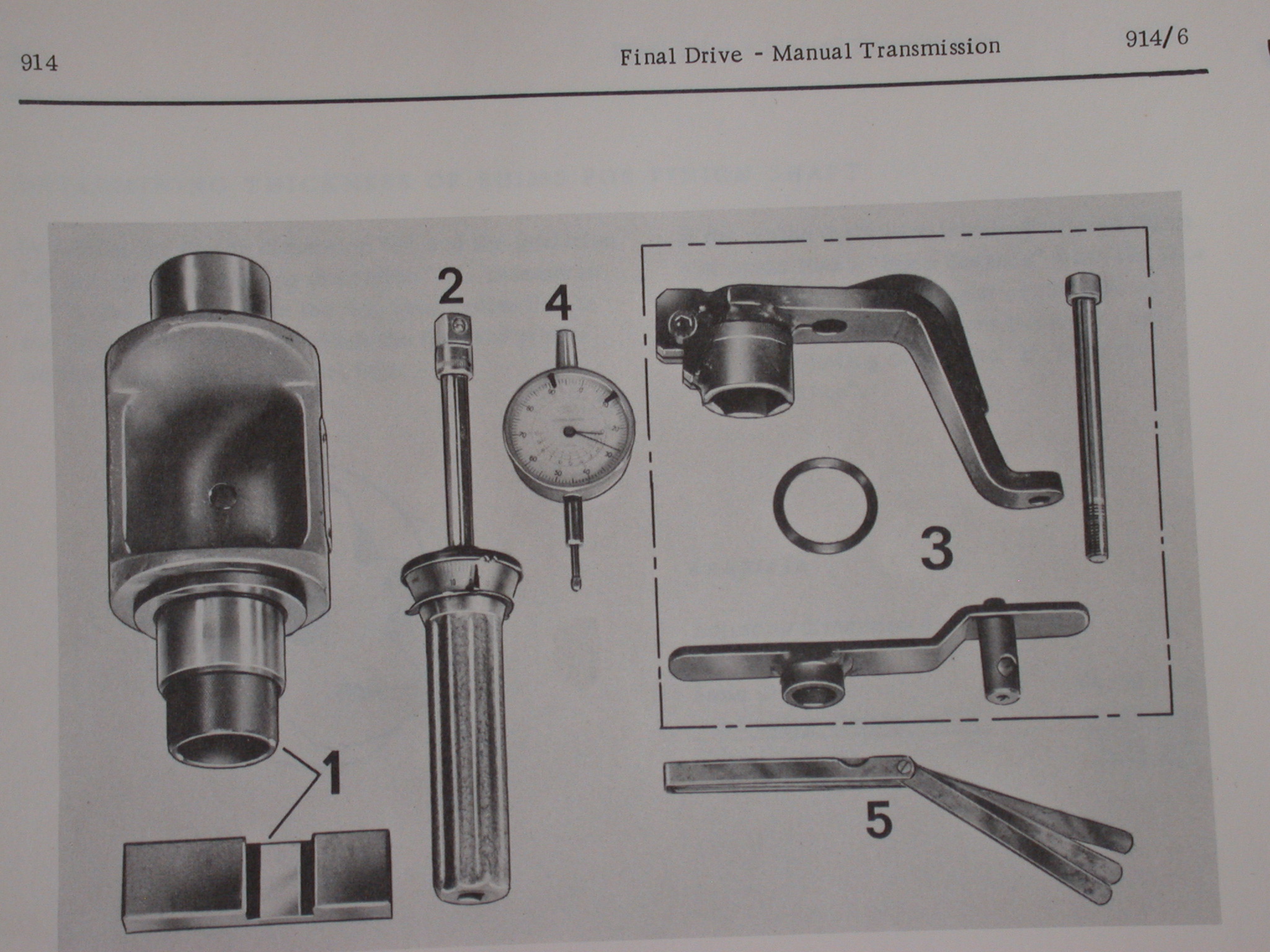

914 Transmission
Setting Ring & Pinion
Factory Tools
P258 Pinion Depth Gauge
P258b Bearing Sleeves
P259 Backlash Set
P261 Torsiometer
P357 Locking Disc, Indicator Tip
Suitable tools can be purchased or made as substitutes
Jon B,
Vista, CA

Jon B   914 Transmission Measuring differential bearing pr...   Oct 11 2013, 03:46 PM
396   Thanks for the indepth education. Now we know who ...   Oct 11 2013, 03:54 PM
Jon B   914 Transmission Setting Ring & Pinion Factor...   Oct 11 2013, 04:03 PM
