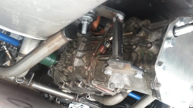

I can't find the thread now, but I promised some photos of my Subaru cable linkage, with a rule for dimensions. Seem to be several projects getting to this point, so hopefully it will be helpful. I wrenched my back so it's been slow, sorry, but here are a few.
General layout. The cable going through the center of the photo is anchored on the left at the sheath to the main bracket, then connects to the shift rod bracket on the right, attached to the shift rod coming out of the transmission. That cable is the shift rod in and out. The rotational cable connects to the bottom of that same shift rod bracket, on the right. The main bracket is the important piece, it locates all the cable sheath anchors. This is the best view of the reinforcing gusset that keeps everything stiff.
(IMG:http://www.914world.com/bbs2/uploads_offsite/i379.photobucket.com-2618-1381090895.1.jpg)
Same view from below and a little further back so you an see the cable sheath mount for the rotational cable.

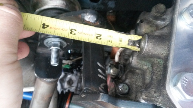

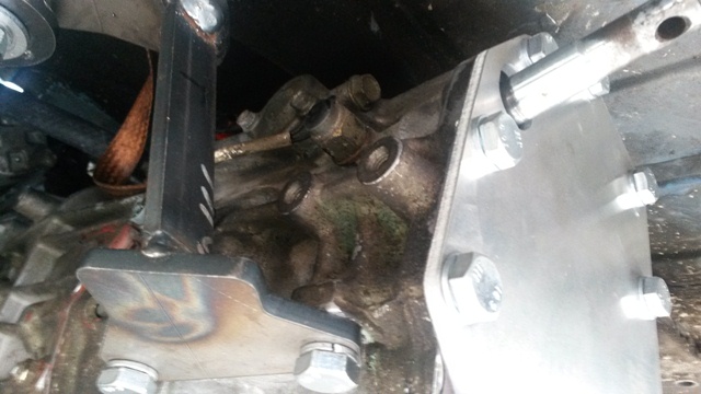

Same direction of view, but a little around the main bracket so you can see the shift rod bracket. That's the important dimension for full throw of the MR2 shifter, 8.5cm from the center of the shift rod to the cable heim center.
(IMG:http://www.914world.com/bbs2/uploads_offsite/i379.photobucket.com-2618-1381090895.3.jpg)

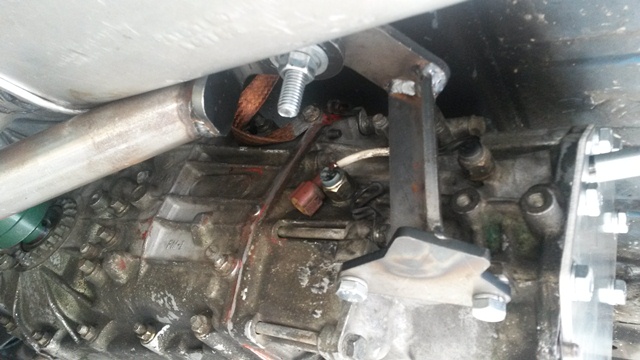

Another, that same bracket and dimension. This is the best view of now that bracket attached to the transmission shift rod:
(IMG:http://www.914world.com/bbs2/uploads_offsite/i379.photobucket.com-2618-1381090895.4.jpg)

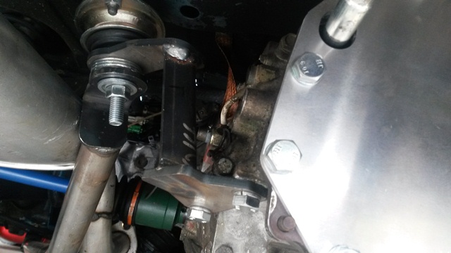

Same components, different view. The main bracket curves out from the transmission mount to put the sheath attachment point out in the same plane as the shift rod. In the photos above you can see the shift rod bracket is bent in toward the rear of the transmission to keep that cable movement in the same plane. You can also see more of the main bracket gusset (that triangular shape). Need that gusset to keep it all stiff, minimize cable shifter "mush".
(IMG:http://www.914world.com/bbs2/uploads_offsite/i379.photobucket.com-2618-1381090895.5.jpg)

Shows the main bracket size. This isn't a critical dimension, but it will give some perspective, maybe help. that 5" measurement is from the point where it attaches to the transmission to the cable sheath anchor tab for the rotational cable.

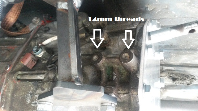

DB, do any of these help? I just noticed a couple of threaded holes in what looks like a good location on my trans to bolt a bracket to. You'll see them in the pics. Hopefully this is a common layout. There are a couple inches of clearance between the trans mount and the trans as you can see and I wouldn't have a problem notching it a bit if necessary. It's over-engineered (that's a good thing) and most of the weight is in the front with this layout.

QUOTE(Chris H. @ Oct 12 2013, 01:59 PM) *
Those are the holes used for the transmission bracket in my setup, and that measure, looks about 1-3/4 to 2-1/2 inches, puts that angle iron right in the middle of where the cable runs for my shifter. Means that what I have won't work in the current form with that cradle.
There are a couple of solutions, a bell crank, or an extension of the mounting point on the shift rod bracket, so the cable can run parallel with and closer to the transmission, so it fits in that 1-3/4" space between that angle iron and the trans case. Unfortunately that extends the cable mounting point outwards from the shift rod, meaning that cable end will move more, up and down, when the shift rod is rotated. I don't know if there is enough cable beyond the bracket where it mounts to let it flex enough for that.
Another possibility is drilling a hole right through that angle iron, threading the cable through the hole, and mounting the cable sheath there. You say it's over engineered, and it looks huge, do you think it's strong enough to maintain strength with a 3/4" hole through it? It looks like the angle iron comes down at quite an angle, which may make doing that problematic. The bad thing about a mount that's not on the transmission itself is that it can flex independently of the transmission, moving the cable end and the shift rod in ways that aren't good. But that all looks solid, no soft mounts anywhere between the cradle and the transmission. Anyway, give that some thought, and give me a a little time to see what's possible.
