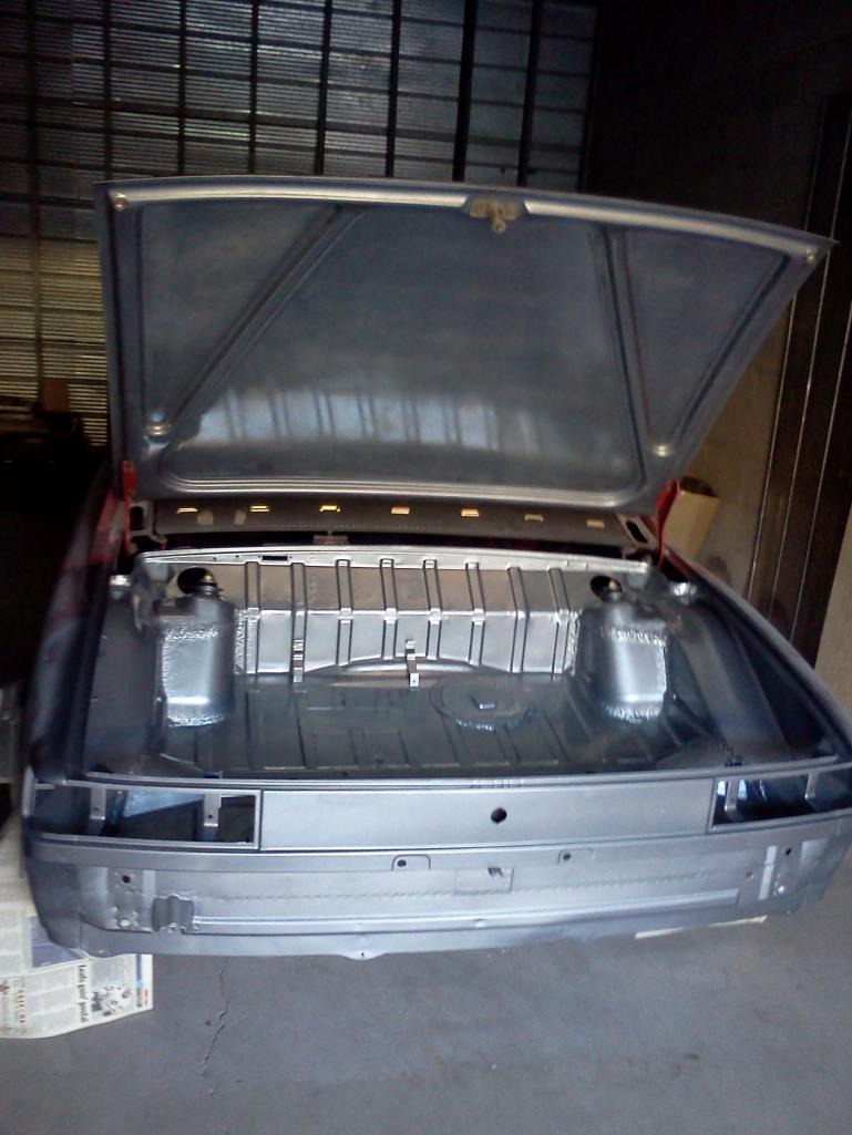

Hi Marcus-and all
I have recently purchased a cherry tomatoe '72.
I am Vic in the T.O. and have decided to follow your lead
and install an American F6 in the tail(er mittle) of my 914.
I have begun the restoration of the body/paint without the usual
sheetmetal fabrication or replacement.The car is virtually rust-free
and SoCal condition and therefore rare in the salty environs of Ontario.
The VW repair shop proprietor had installed a later 2L and TX
but could no longer devote the time or space to the project.
As it was stored indoors 10+years after a 70's repaint it only
requires some hand sanding.
Having owned a '62 Beetle in the early 70's I cannot get past the sound
of the VW-Porsche F4.There is available a '05 3.6 for 3.5K as a core locally
but alternatively I purchased 2 110 Corvairs for 0.5K instead.
The vendor decided a Lycoming O-320 was more suitable for his aircraft.
I have been reading the progress reports and dialog of so many different
sub-versions of the NARP 914's with great interest.As I now have taken the
first steps to replace the 2L I trust you are trailblazing the way ahead of me.
I have not yet put a wrench to the F6's.
I'll post again soon with pix as this is the second time I am typing this.
(typo delete)
vic
