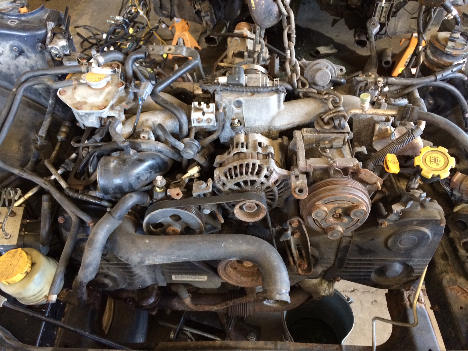

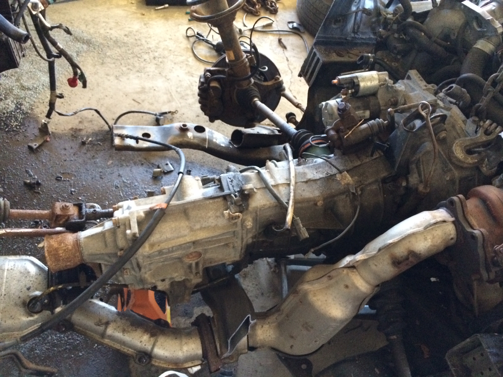

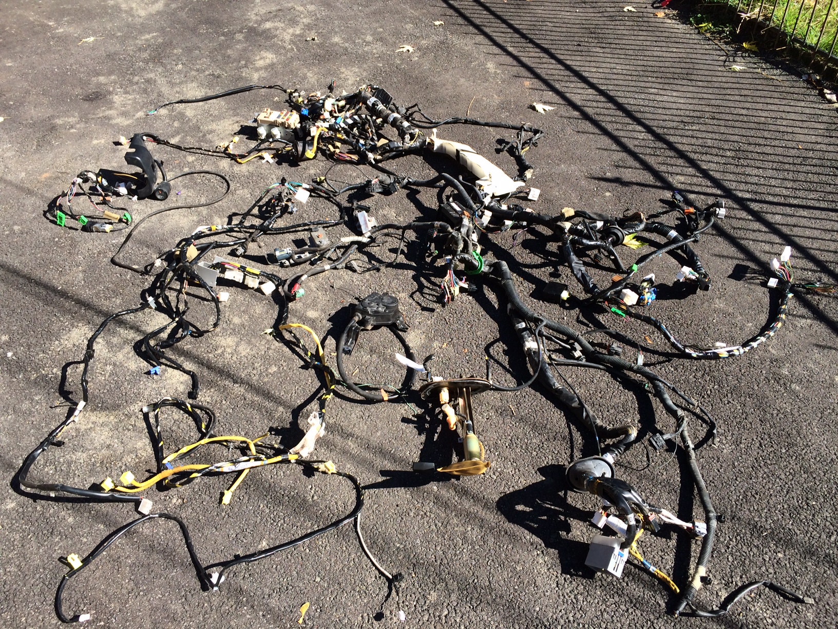

Alright Mark...I'm in the garage!
Got to the "Donor WRX" today to start pulling stuff. I have NO idea how much of the wiring harness I'll need, so I just grabbed all of it. Every inch of wire from the entire car. I'm sure it's overkill, but I'd rather have more than not enough.
Ian told me last week "do yourself a favor and just send the wiring harness off to Small Car Performance" and I think I'm A-OK with that, after seeing the magnitude of what is needed for the wiring. There's 60LB of stuff here, and I'll bet I get 10lb back.
Also have most of the engine out of it. We just sawzalled the front clip so we could get a little deeper into it without restriction. I should have everything off in a week or so as I get closer to pulling the V8 out of my 914.
I'm toying with the idea of having someone else re-build the motor. Just to be on the safe side. I'd rather KNOW I'm starting with something that's solid. Besides, now is the time...right? I can also put some upgrades inside and add a few HPs in the meantime.
So...that's a little progress. Right?
