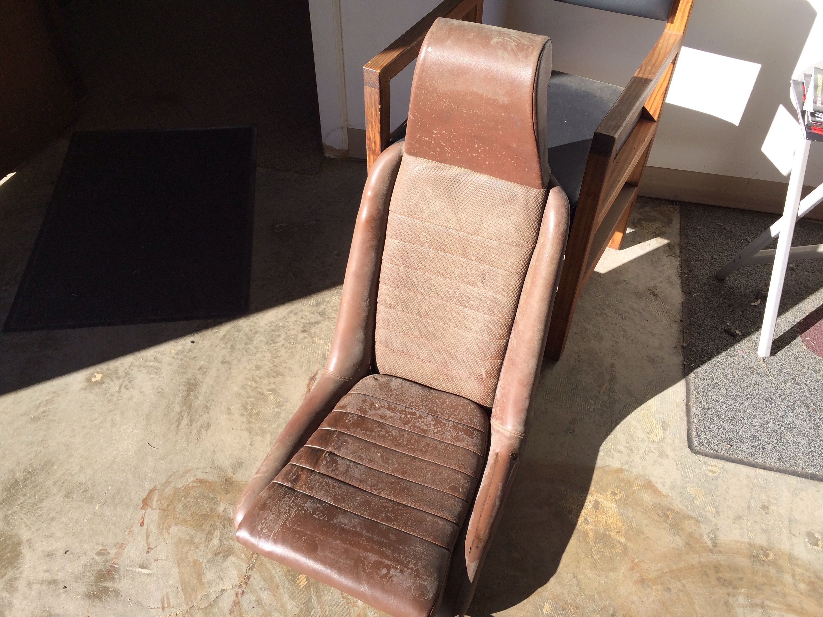

Decided to skip the Boxster seats, and took the seats I had in my basement to an upholstery shop today.
Going with a dark gray leather outer, and suede centers. Should take them 6-8 weeks so that's fine by me.
