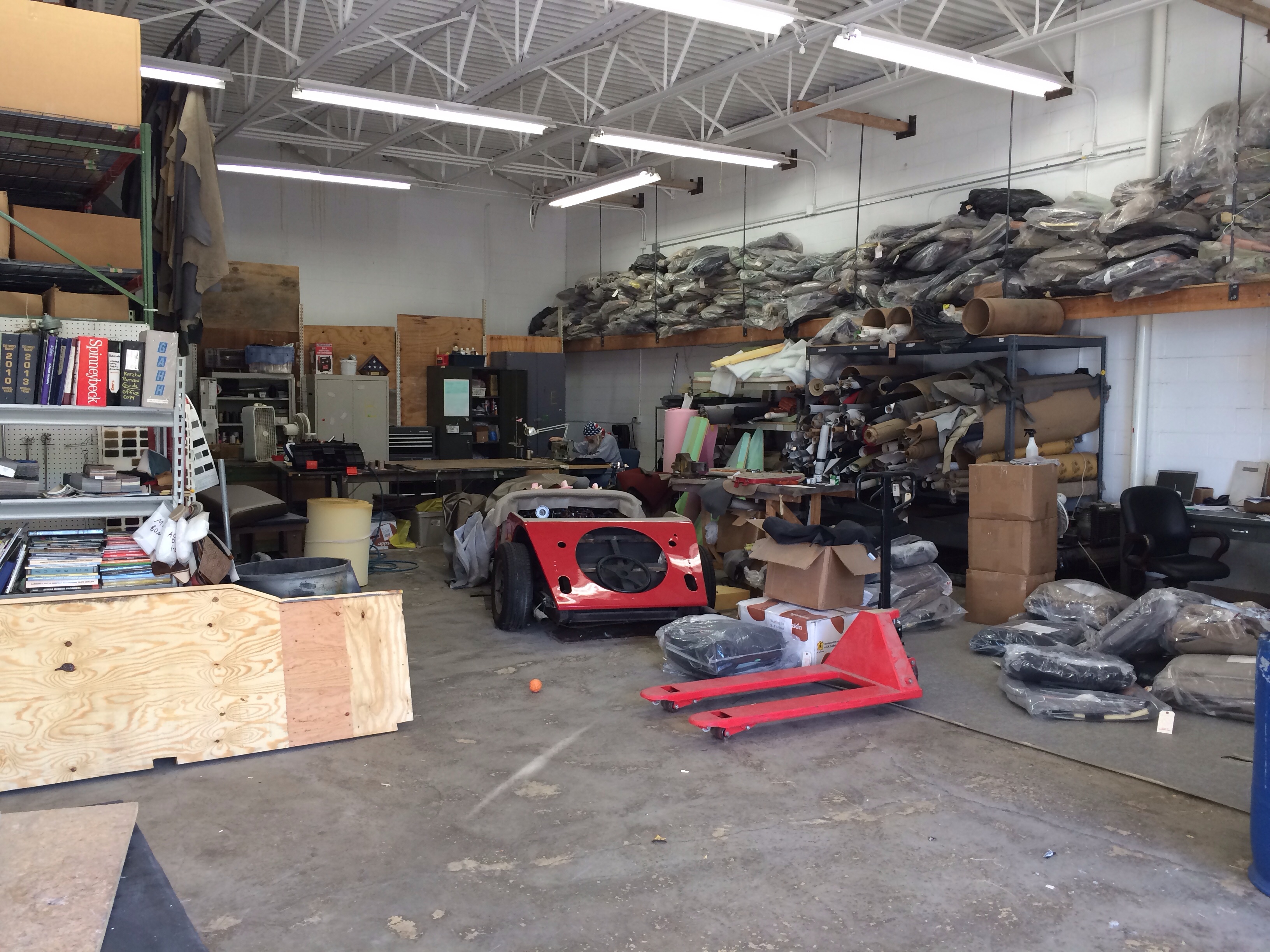

CptTripps
post Oct 14 2013, 04:18 PM
:: Punch and Pie ::
Posts: 3,586
Joined: 26-December 04
Member No.: 3,342
I knew I was in the right place when I walked in and they we're doing the interior on a Morgan. :-)
