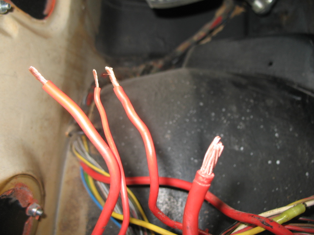

I actually installed the fuise box months ago without a battery in the car. today I was hooking up a parking light when things went bad. still I should have disconnected battery.
question is how best to butt these 4 wires together? the fattest one must be 8 awg or fatter?

mikesmith   question is how best to butt these 4 wires togeth...   Oct 16 2013, 10:01 PM
