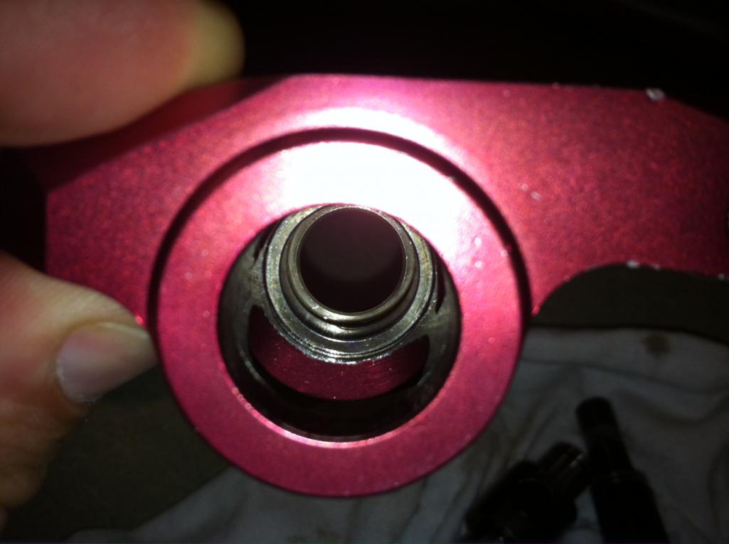

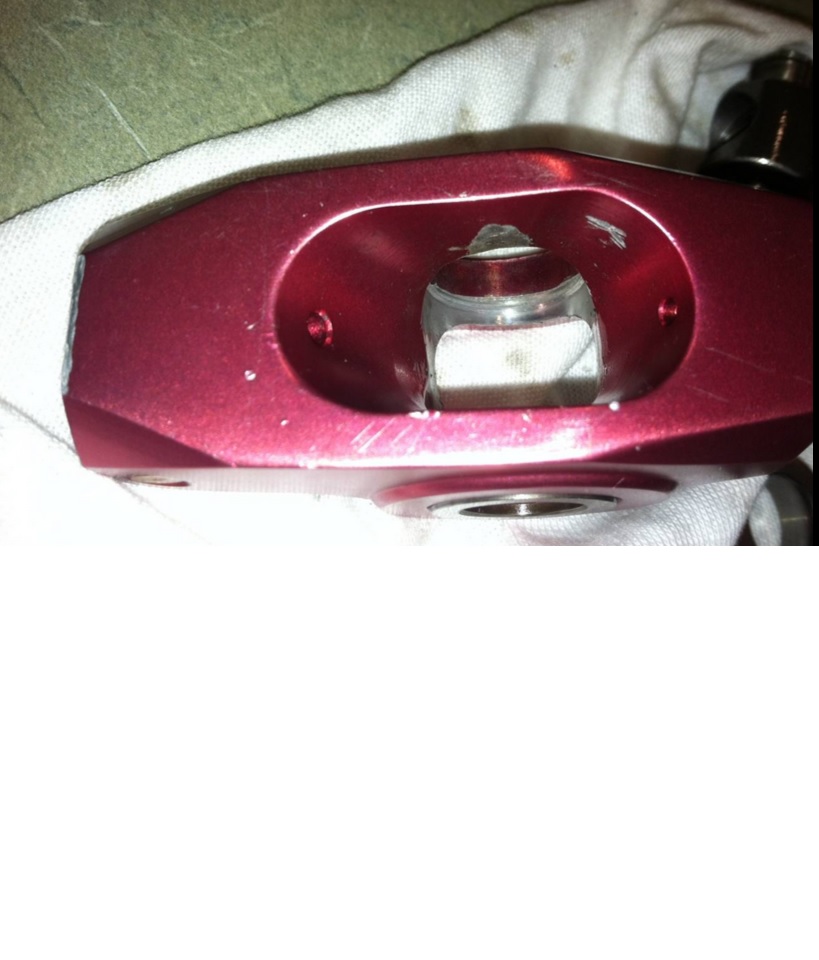

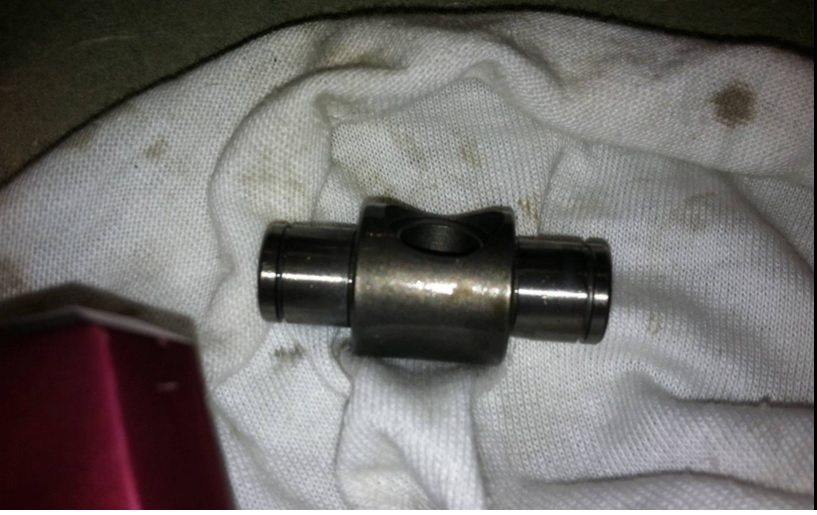

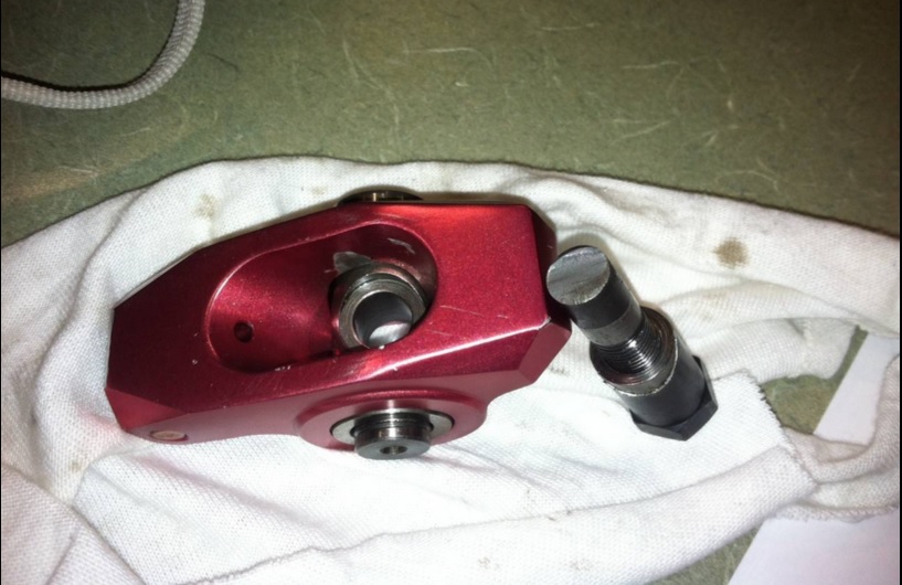

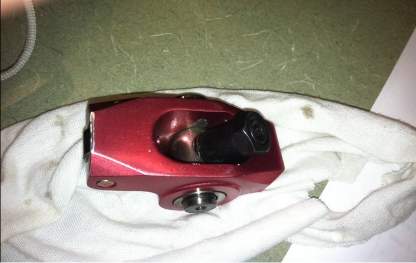

Here are the pics of my roller rocker failure. It appears the circlip may have failed---> then the needle bearing ----> then the stud. Not bad as it is easy to replace.
For my 3130 I bored the case and used T2 2.0 P/C. The studs were checked and the registers opened to fit the spigots. No issues as of yet, with this part (IMG:style_emoticons/default/rolleyes.gif)
