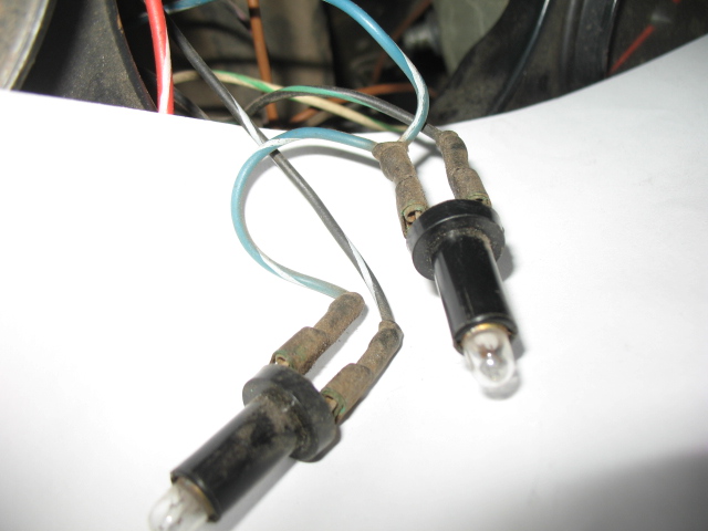

my 1972 car has the problem of both directional indicator lights in the tach flashing together regardless of which direction I want to go.
so disconnect the bridged blue/white wires and tape them up, and connect the lamp socket spades to ground?
thanks
jim
Spoke
post Oct 25 2013, 07:00 PM
Jerry
Posts: 7,436
Joined: 29-October 04
From: Allentown, PA
Member No.: 3,031
QUOTE(jimkelly @ Oct 25 2013, 08:51 PM) *
spoke
are you saying to connect the blue/white wires to ground?
This problem is caused by a failure of the secondary relay contact in the flasher. You can replace the flasher or make the change to the wires.
If you change the wires, yes, connect the common connection of the lamps to ground. Cut and tape the blue/white wire to the relay. Then reverse the other wires on the lamps. Left wire to the right lamp and right wire to the left lamp. I made this change to the flasher in my '71.

jimkelly   spoke my 1972 car has the problem of both directi...   Oct 25 2013, 06:51 PM
Spoke   spoke my 1972 car has the problem of both direct...   Oct 25 2013, 07:00 PM
jimkelly   thank you :thumbsup:   Oct 25 2013, 07:24 PM
