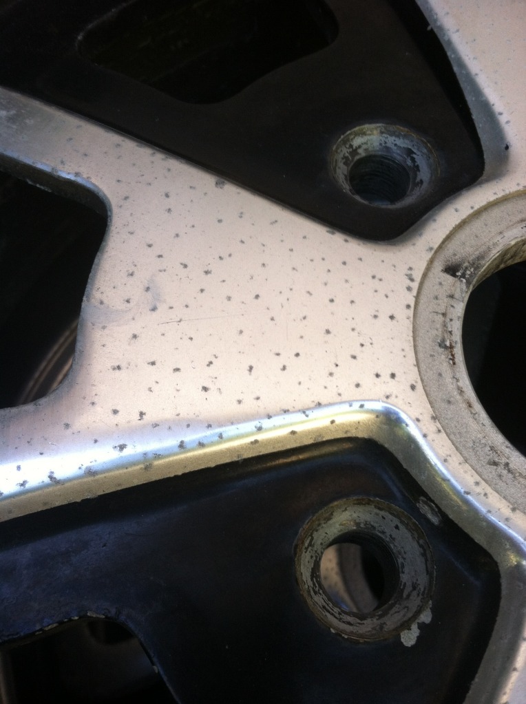

This is my current problem with my wheels.
I took some wheel polish to it but no dice.

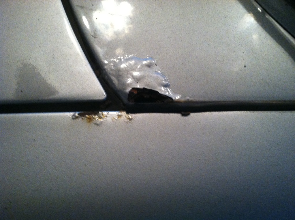

Heres some quick spots of rust i could find, however i did not get to investigate more fully.
I also pushed out one of my axels. the drivers side however will not budge.
Ill need to come up with a solution for that.....

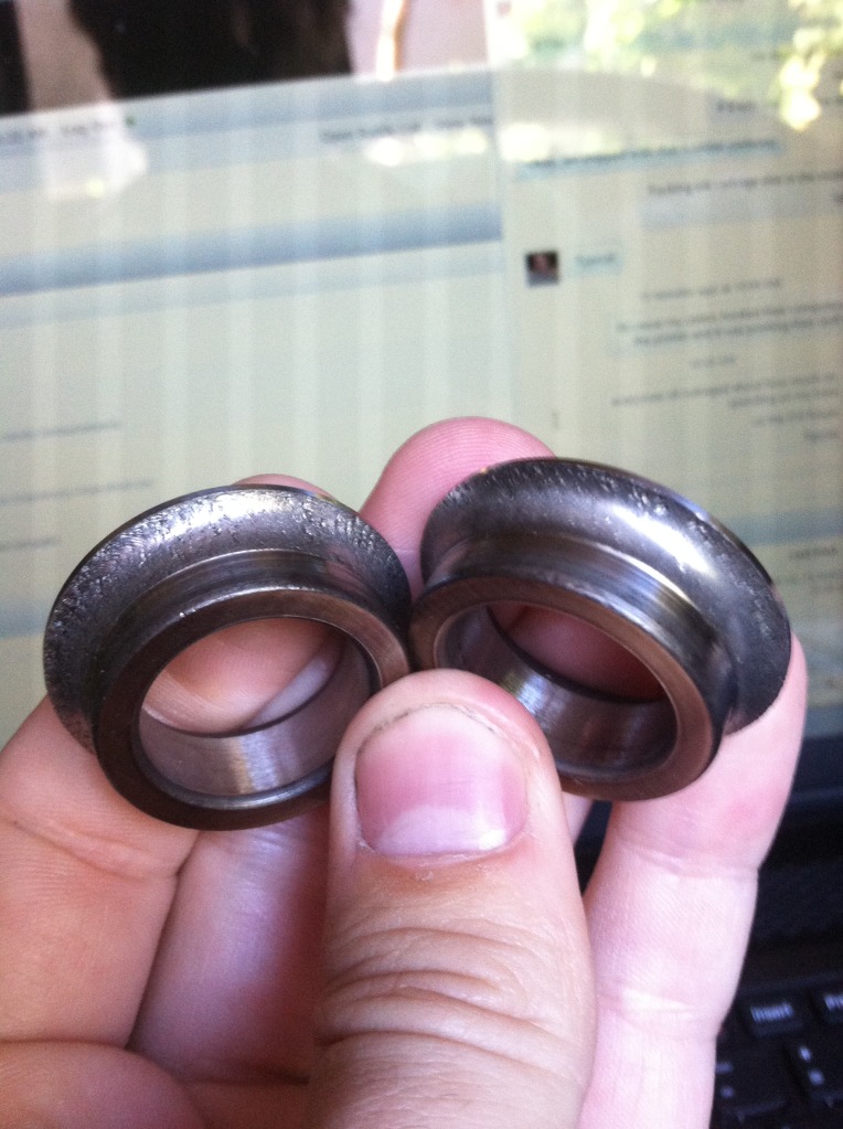

Also this might not be the best picture ever but this is the race set from one of my trans main bearings
(IMG:http://www.914world.com/bbs2/uploads_offsite/i821.photobucket.com-16526-1383380917.3.jpg)
looks pretty borked to me.

colingreene   This is my current problem with my wheels. I took ...   Nov 2 2013, 02:28 AM
