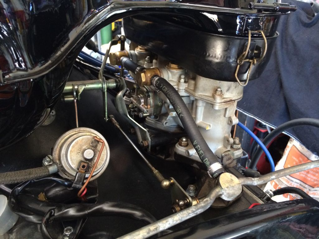

sixnotfour   studs on lower covers and get SC lowers , as they ...   Nov 3 2013, 04:43 AM
bcheney   What a cool story and project. I hadn't seen t...   Nov 3 2013, 10:26 AM

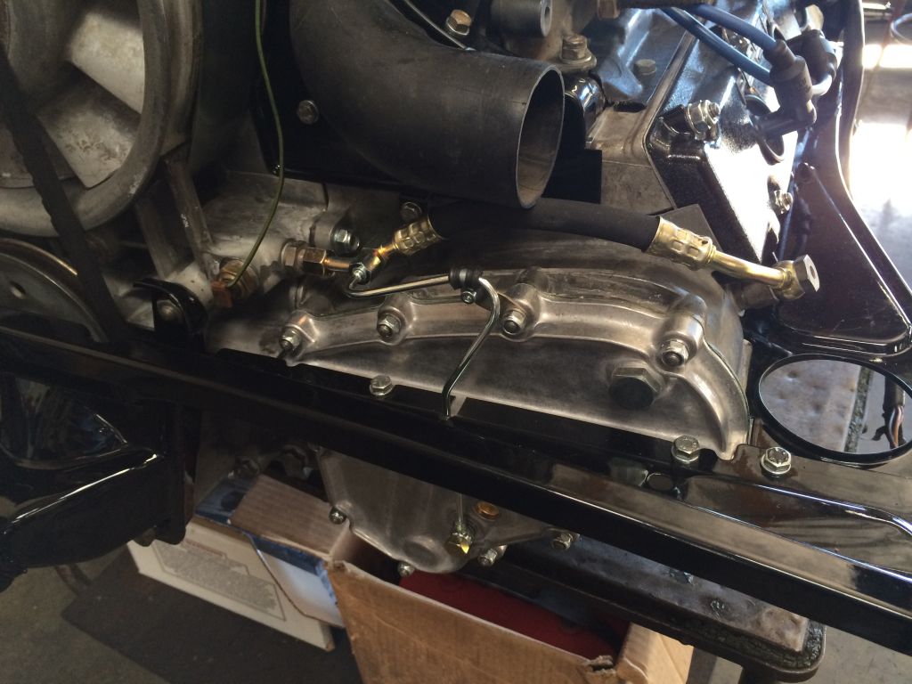

siverson   > The turbo valve covers must be machined down ...   Nov 3 2013, 12:10 PM

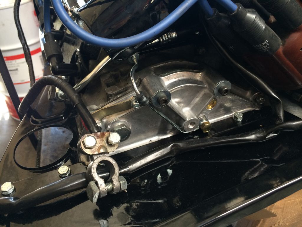

siverson   > fuel lines is one of them Yup, all the fuel ...   Nov 3 2013, 12:13 PM
bcheney   > fuel lines is one of them Yup, all the fuel...   Nov 3 2013, 03:09 PM

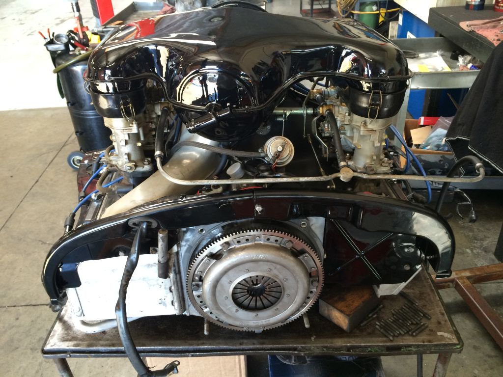

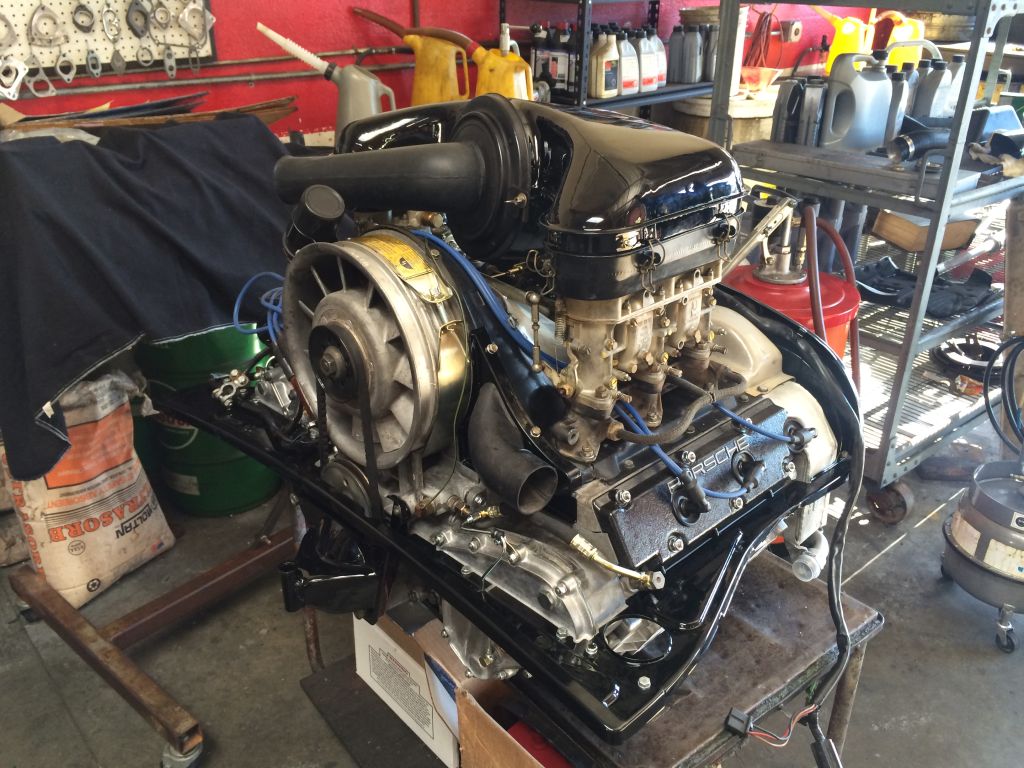

siverson   A couple more photos...   Nov 3 2013, 12:15 PM

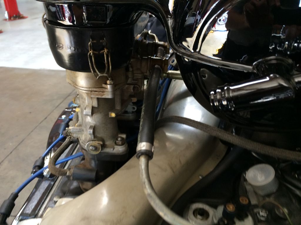

Eric_Shea   Neither one is correct on the air cleaner, that sa...   Nov 3 2013, 03:15 PM
JmuRiz   Re: valve covers. Do you need to machine turbo cov...   Nov 3 2013, 04:53 PM
mepstein   Re: valve covers. Do you need to machine turbo co...   Nov 3 2013, 05:35 PM
rgalla9146   Re: valve covers. Do you need to machine turbo c...   Nov 3 2013, 06:27 PM

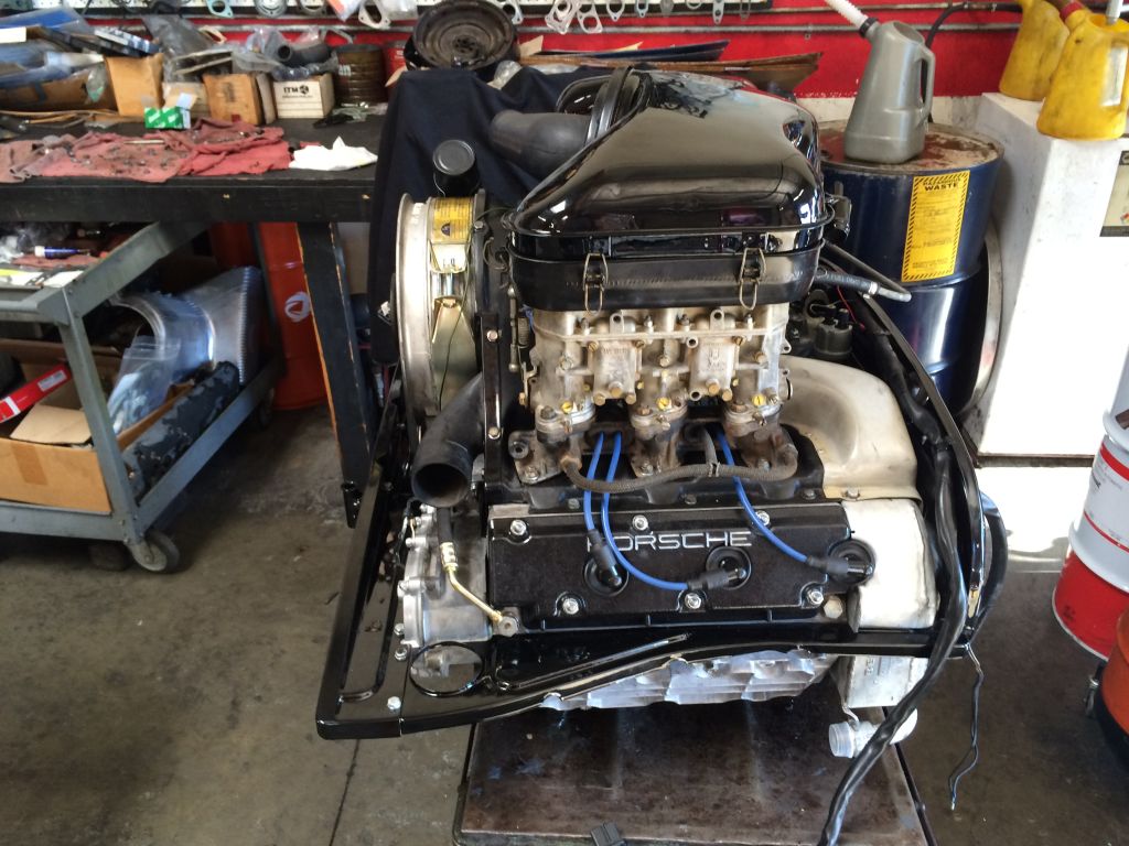

siverson   > original -6 housing is plastic, low profile w...   Nov 3 2013, 09:15 PM
siverson   Or is this one correct? -Steve   Nov 3 2013, 09:50 PM
rgalla9146   Or is this one correct? -Steve That air f...   Nov 4 2013, 08:34 AM
Eric_Shea   :agree: That's the MFI housing I mentioned. ...   Nov 4 2013, 11:18 AM
johnhora   Steve... went and took a couple of shots of the ai...   Nov 4 2013, 12:18 PM
rgalla9146   Steve... went and took a couple of shots of the a...   Nov 4 2013, 05:52 PM

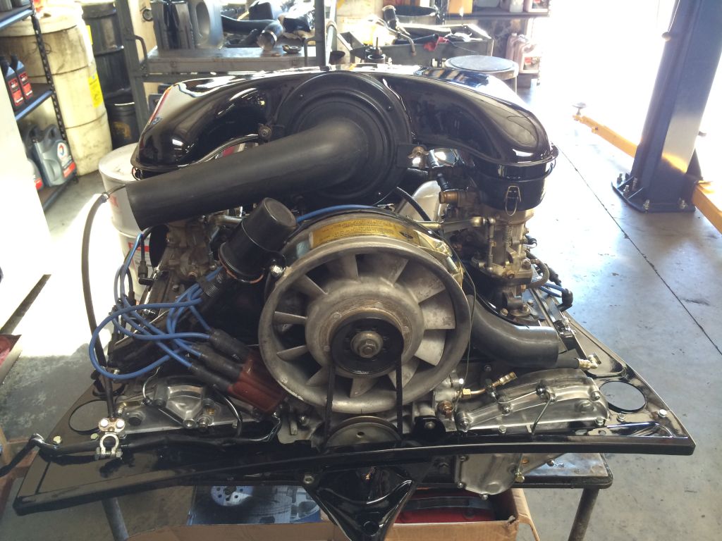

siverson   Car is back and has a fully rebuilt 2.0 now. Wow, ...   Dec 9 2013, 12:02 PM
siverson   914   Dec 9 2013, 12:02 PM
siverson   914   Dec 9 2013, 12:03 PM
JmuRiz   Yep, it's sitting too low, check to see which ...   Dec 9 2013, 12:27 PM
