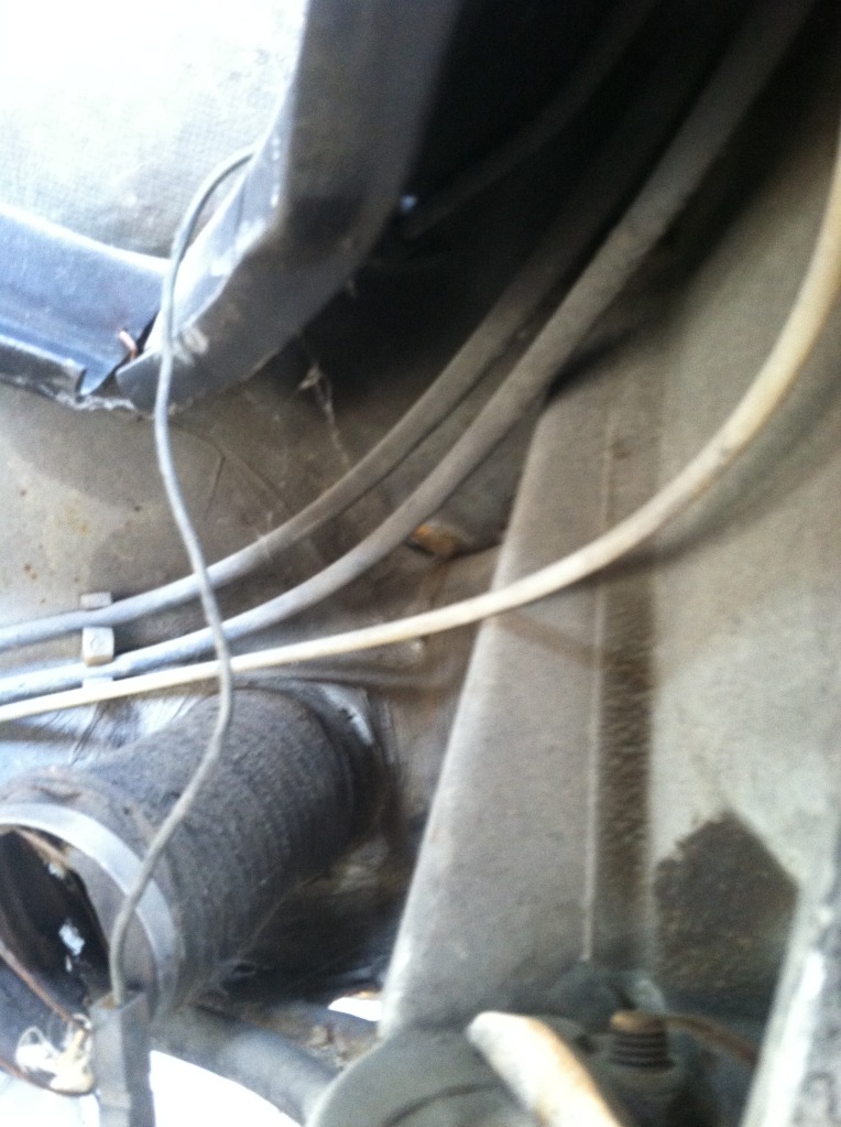

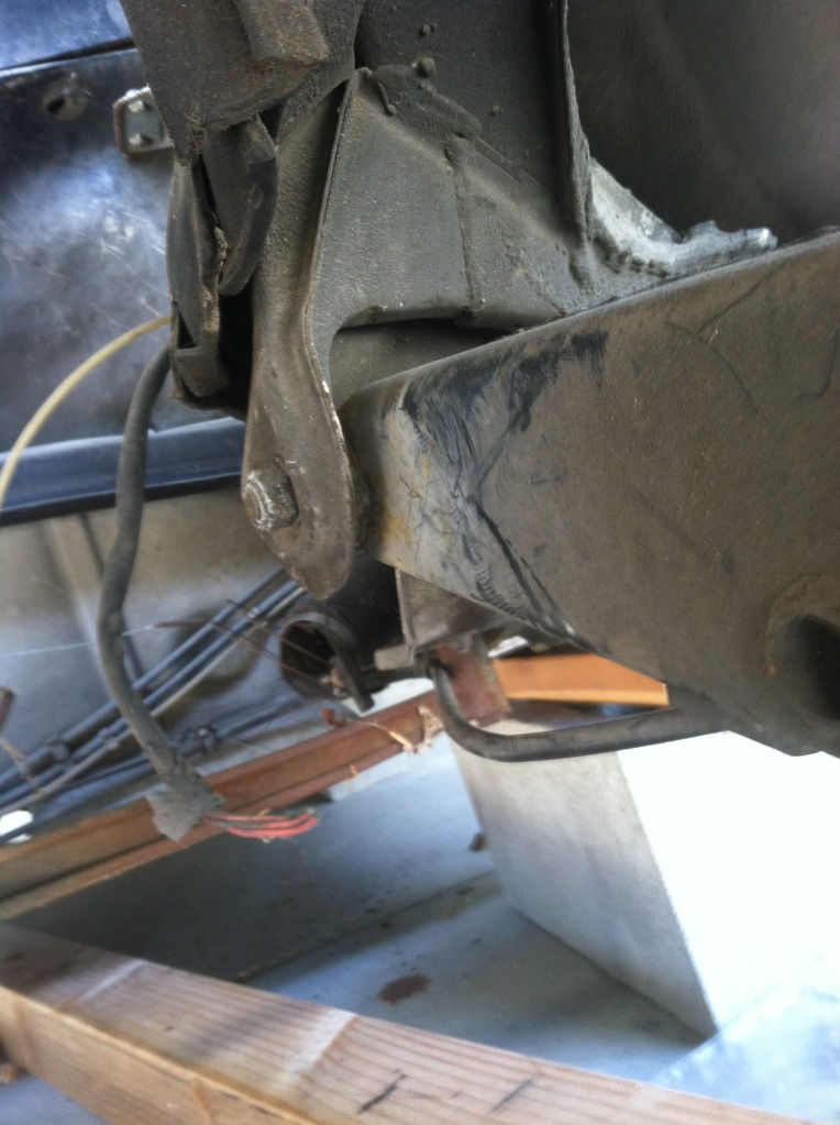

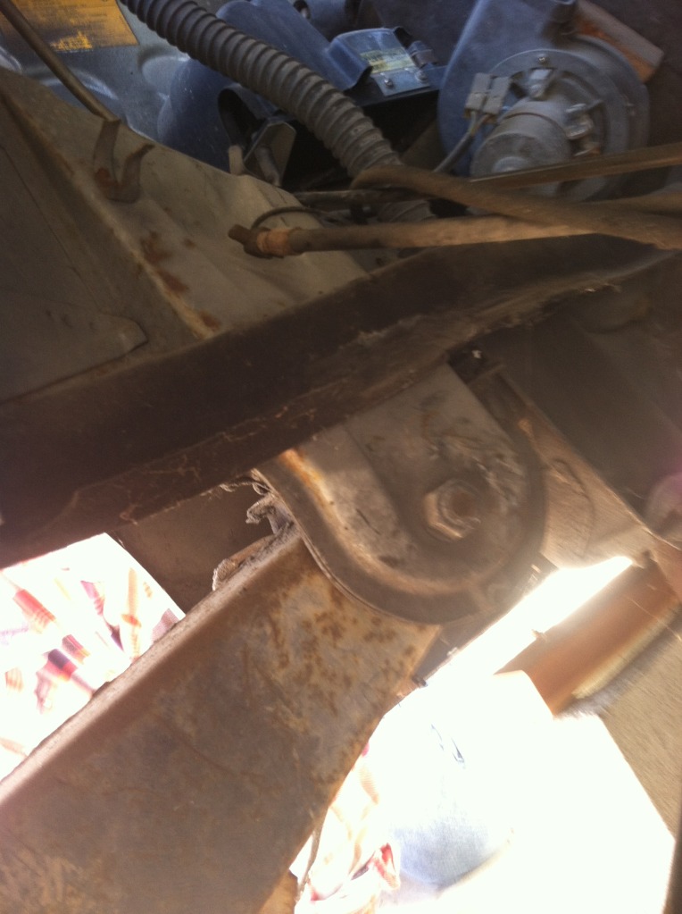

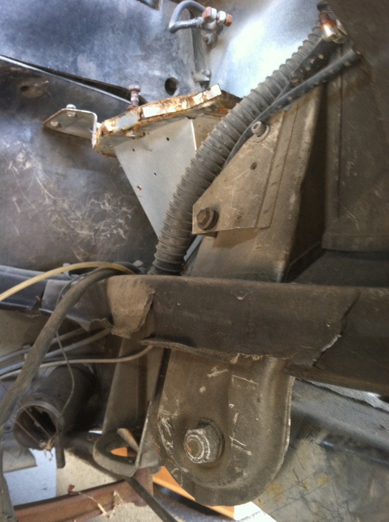

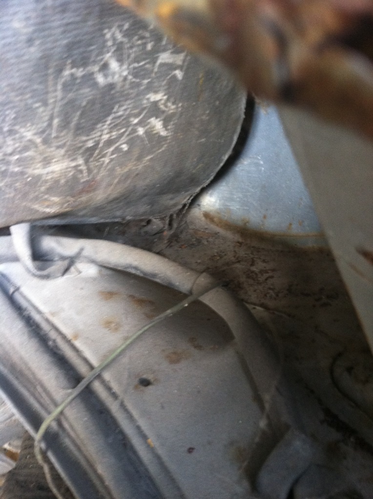

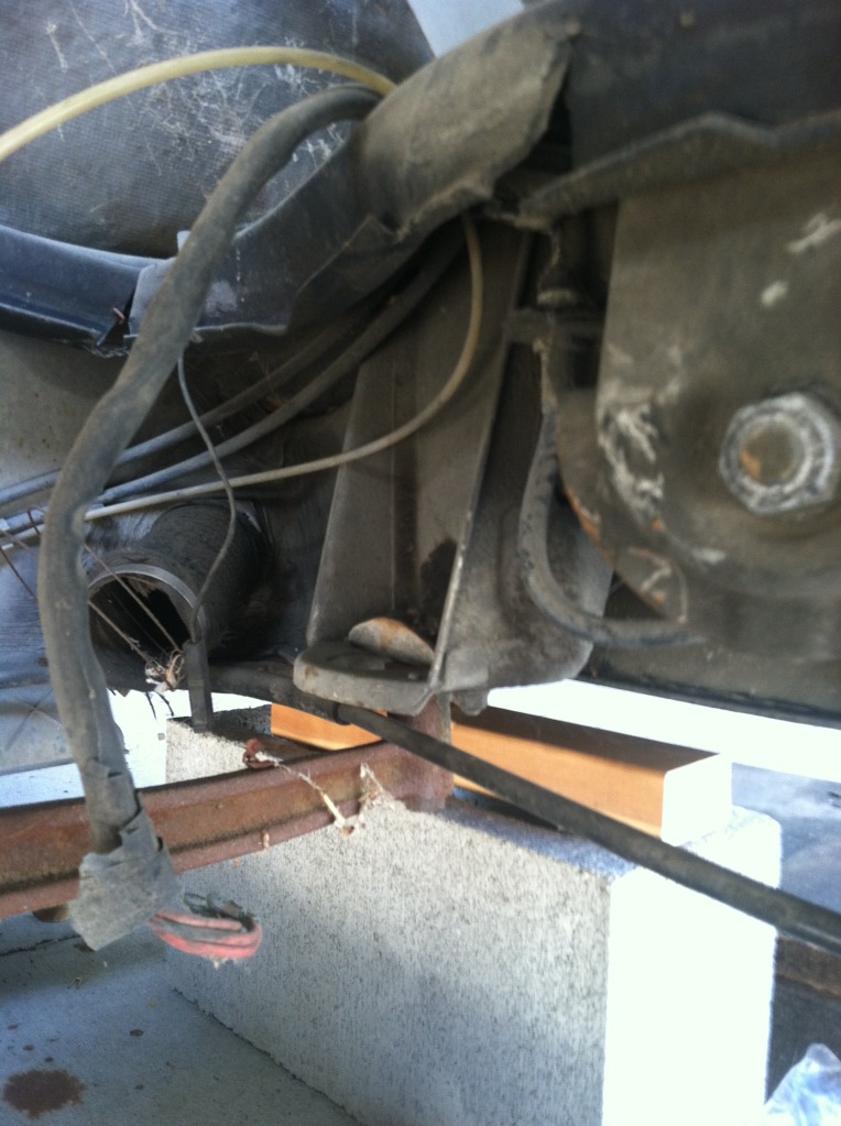

Got a chance to work on the car some today, Took quite some doing to get the drivers side axel out. So much so that i need a new stub axle. If anyones got one let me know.
it was really stuck. anyway i got pictures of most of the stuff you all were asking about so ill throw those up now.
(IMG:http://www.914world.com/bbs2/uploads_offsite/i821.photobucket.com-16526-1383444149.1.jpg)
Drivers side rear suspension pick up
(IMG:http://www.914world.com/bbs2/uploads_offsite/i821.photobucket.com-16526-1383444149.2.jpg)
Passengers side rear suspension pick up
