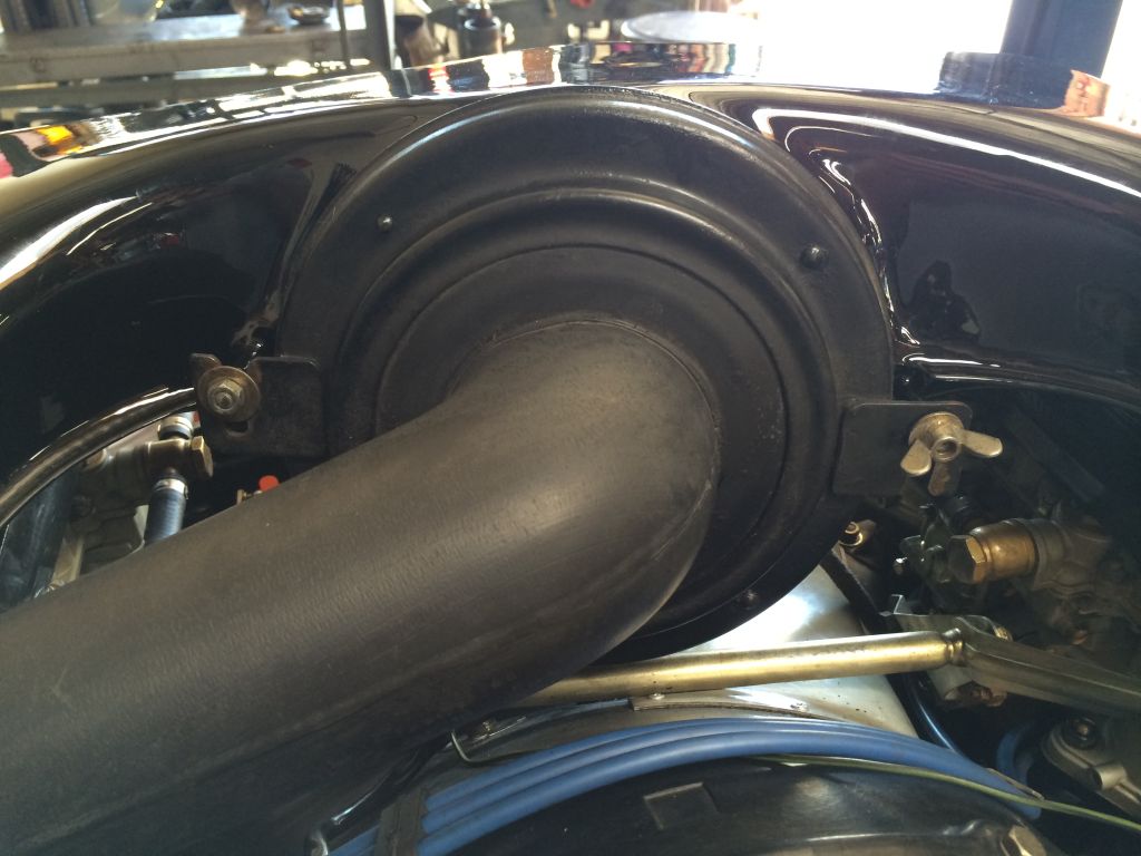

siverson   > original -6 housing is plastic, low profile w...   Nov 3 2013, 09:15 PM
siverson   Or is this one correct? -Steve   Nov 3 2013, 09:50 PM
rgalla9146   Or is this one correct? -Steve That air f...   Nov 4 2013, 08:34 AM
Eric_Shea   :agree: That's the MFI housing I mentioned. ...   Nov 4 2013, 11:18 AM
johnhora   Steve... went and took a couple of shots of the ai...   Nov 4 2013, 12:18 PM
rgalla9146   Steve... went and took a couple of shots of the a...   Nov 4 2013, 05:52 PM
