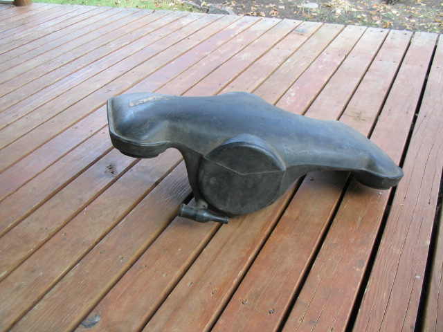

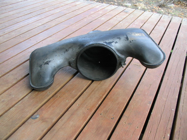

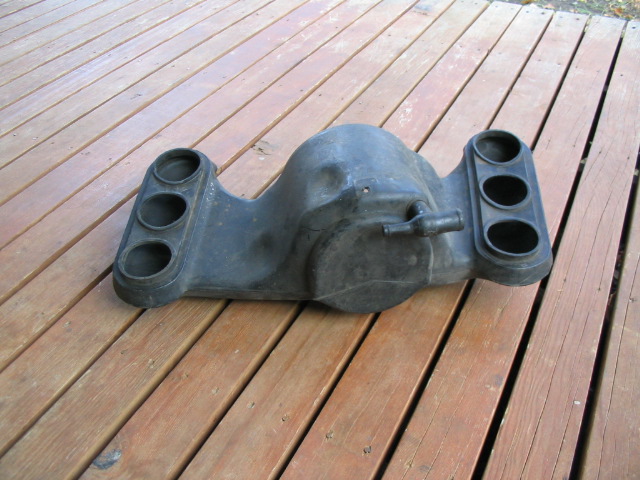

Or is this one correct?
-Steve

QUOTE(siverson @ Nov 3 2013, 10:50 PM) *
-Steve
That air filter is for a 911 with mechanical fuel injection, probably '72-'73
I think it has the plastic stud on one side that is for that application as well.
The Shell oil factory fill sticker is positioned to be read from behind the car.
Also, there are no squirter tubes or plumbing for cold start (or car fire) on that filter.
But it is plastic.
Marelli distributors are hard to find parts for and are less dependable than Bosch distributors. There are many more choices and parts availability with a Bosch.
Best choice would be one for a 911S
