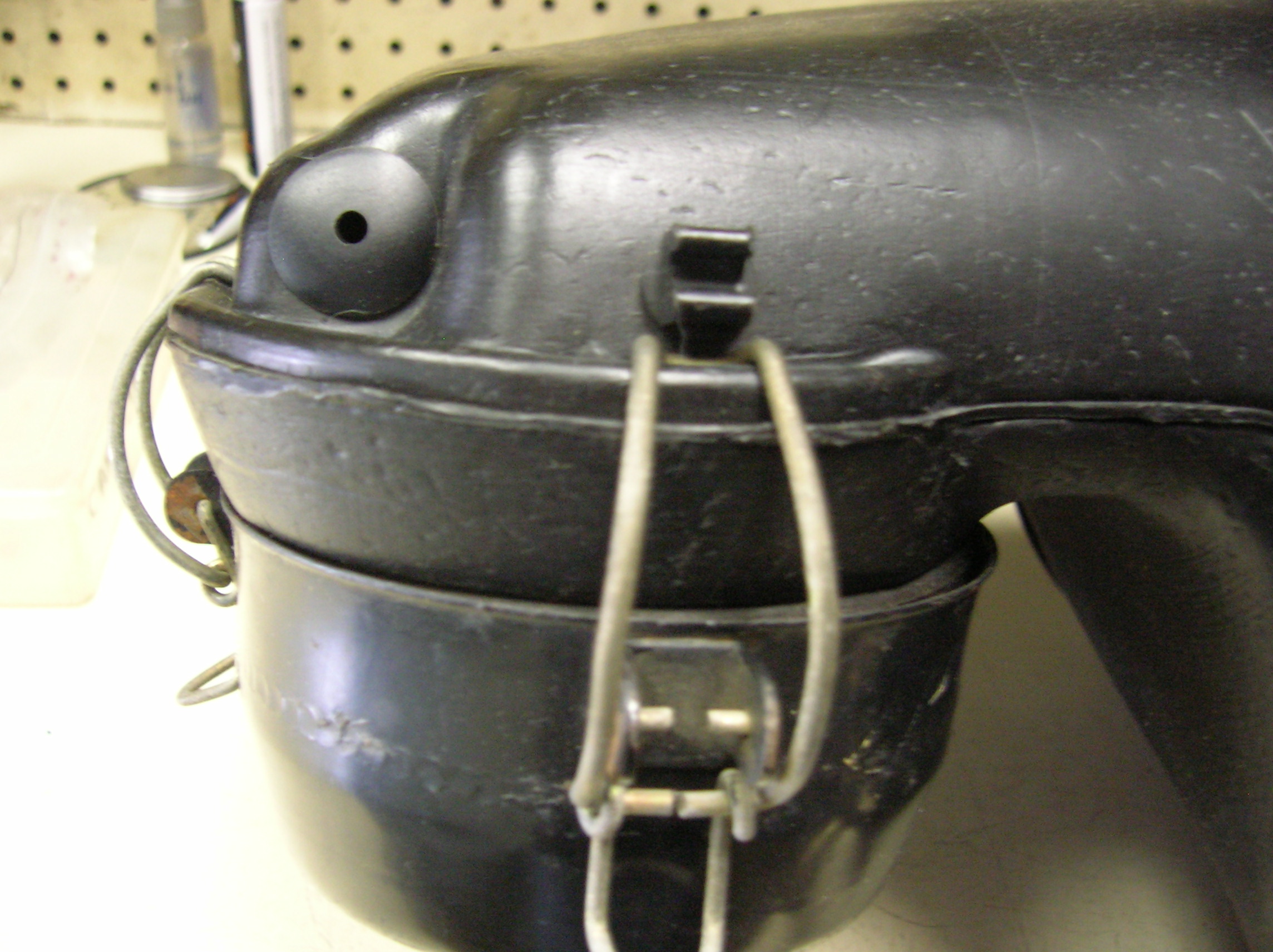

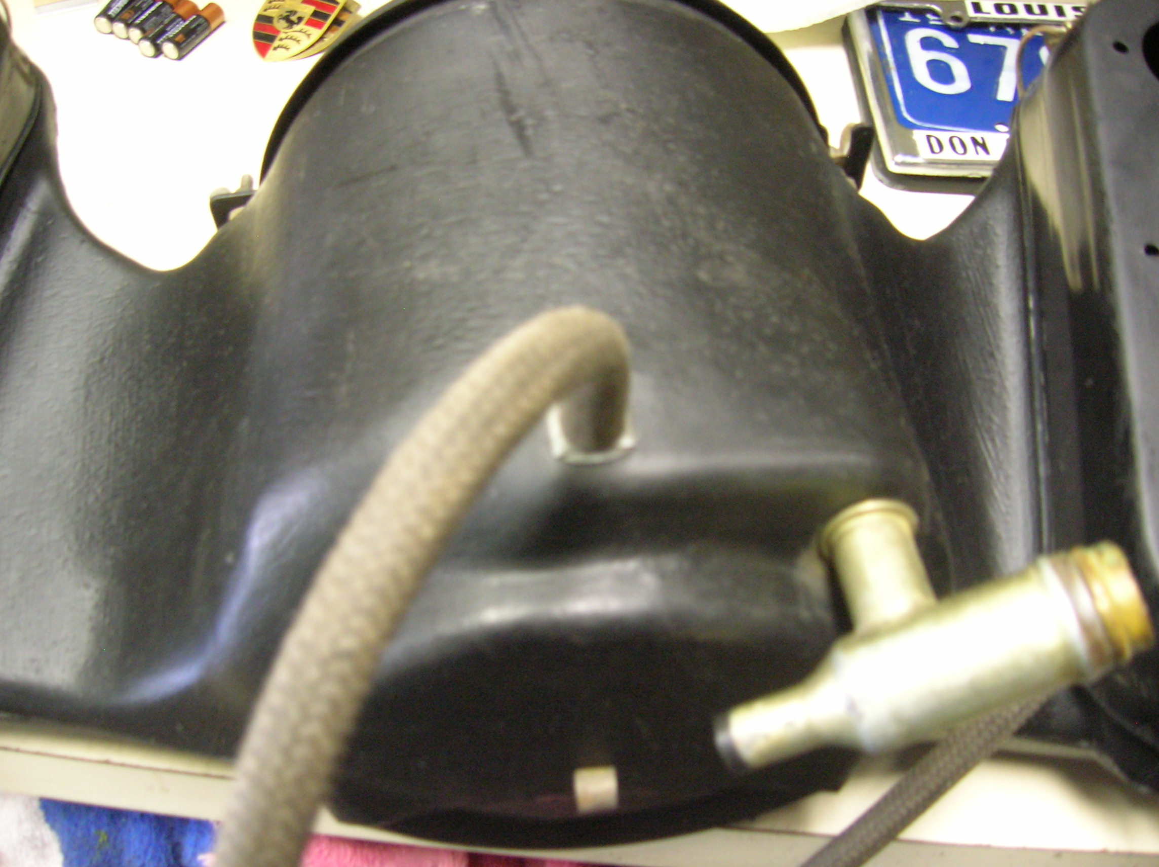

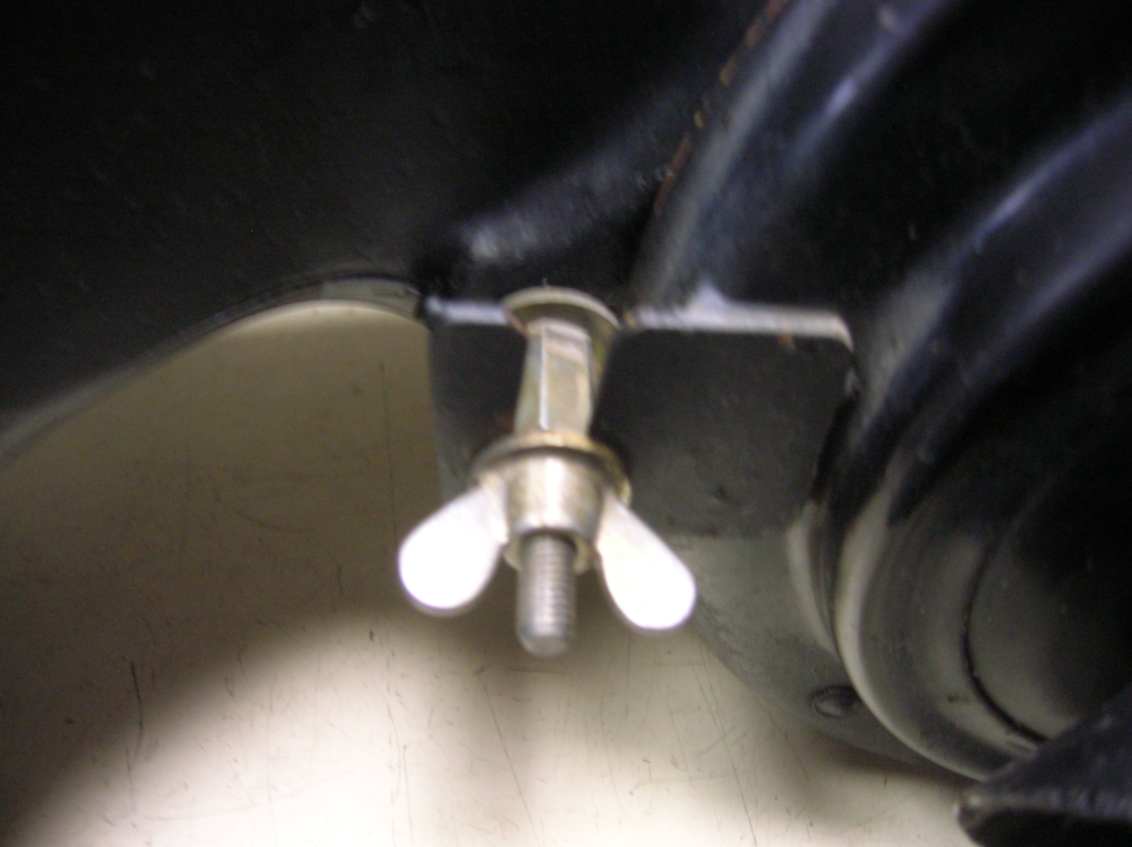

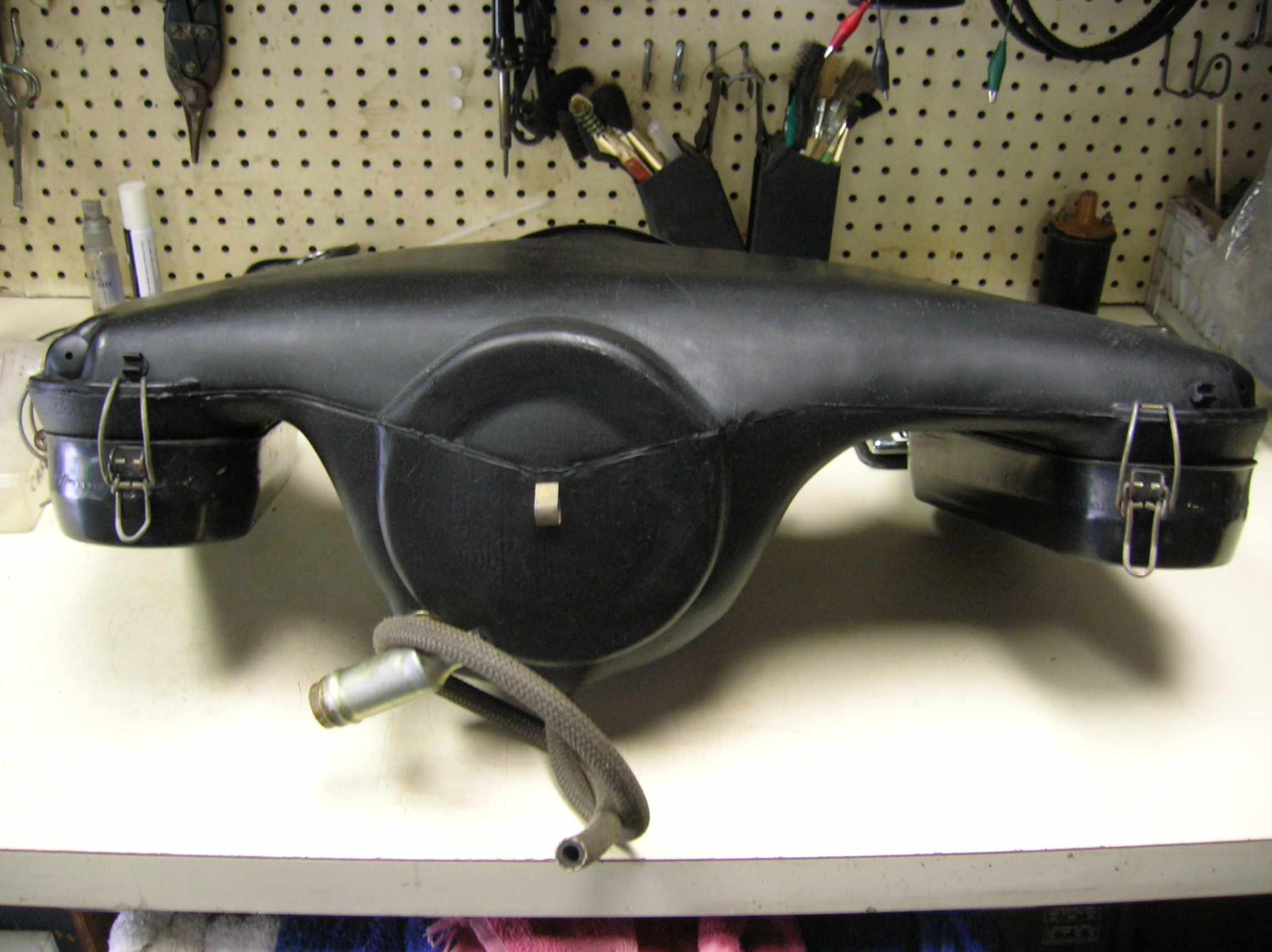

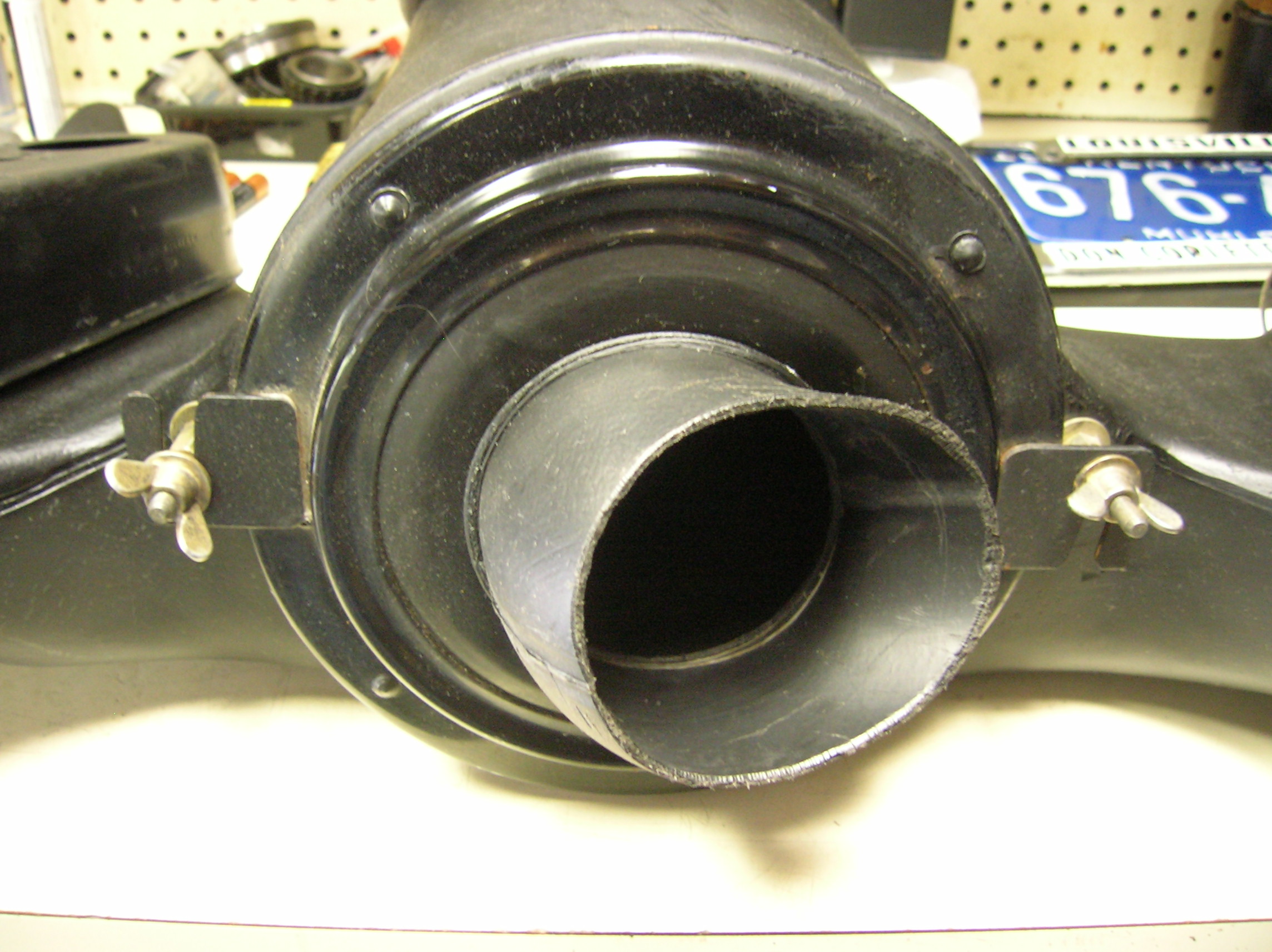

went and took a couple of shots of the air box off my 914-6
my snorkel was cut off (by a PO) long time ago...wish I could find one..anyone have one for sale??
you can see the holes for the cold start arrangement...they are plugged up right now
with plastic hole plugs....it has metal studs, washers, and wing nuts for the snorkel and metal breather hose inlet...
