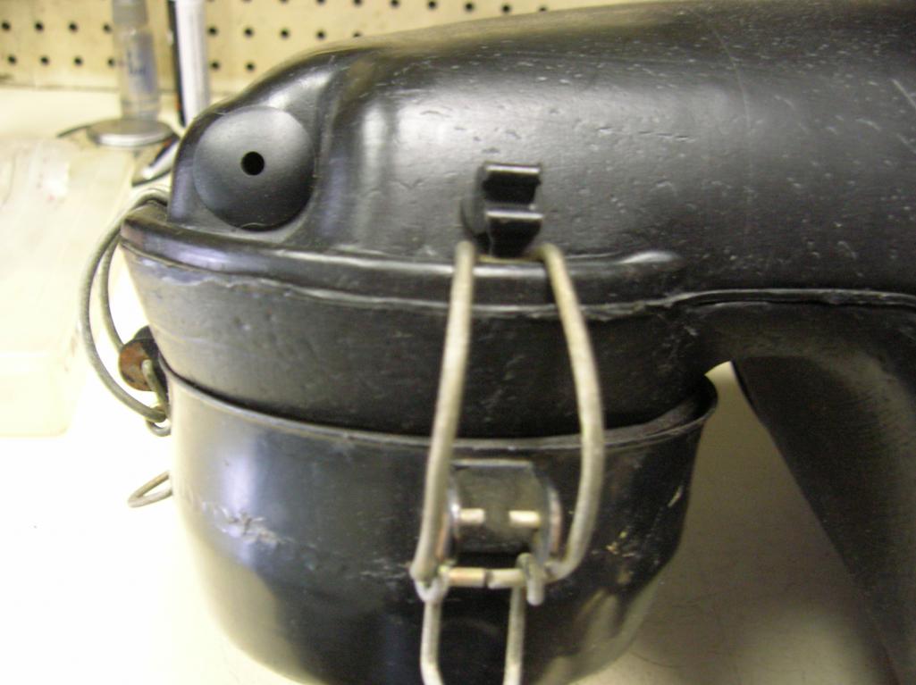

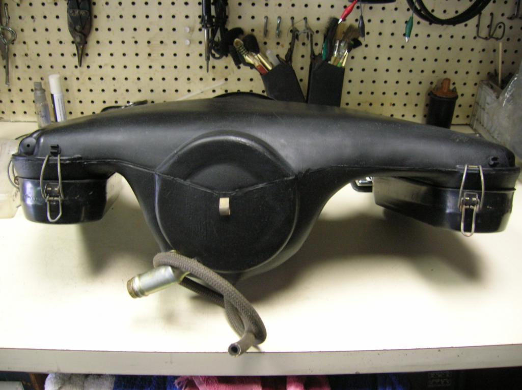

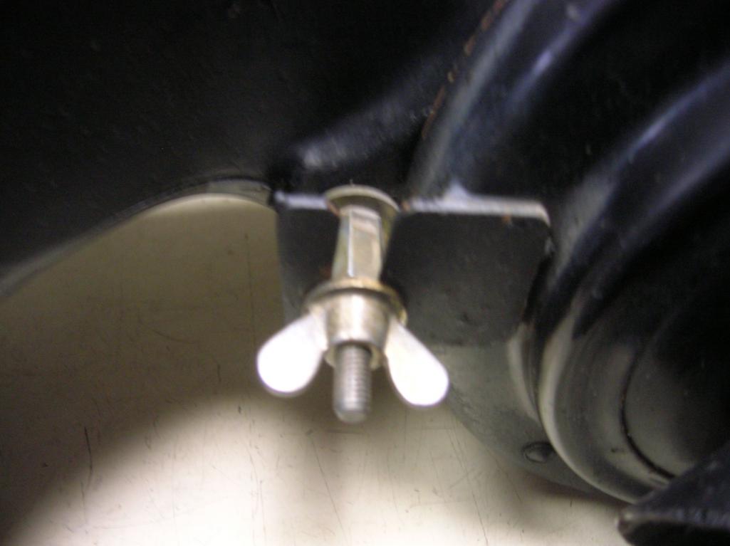

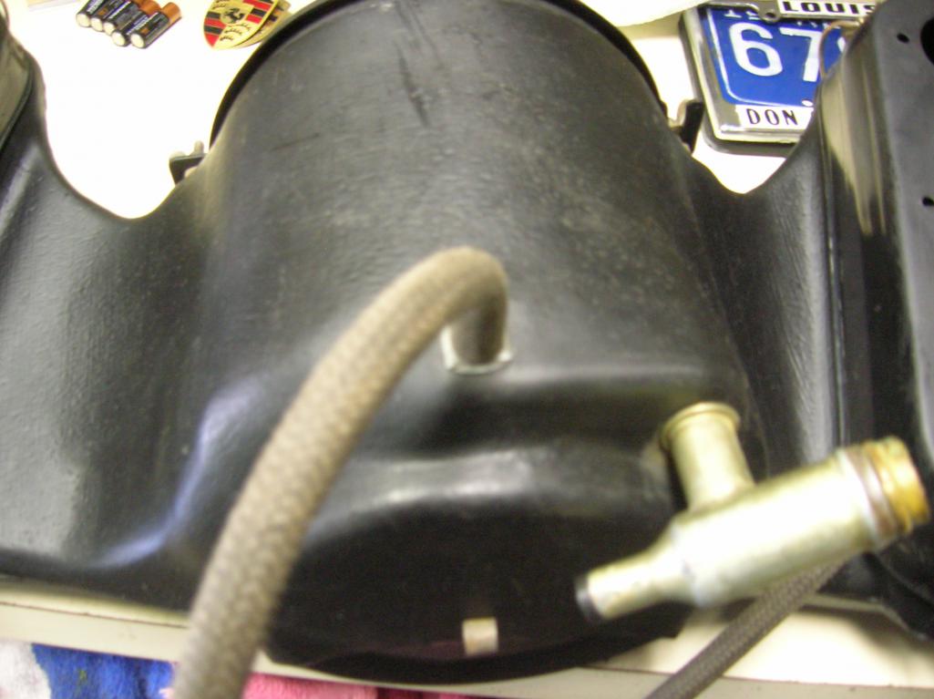

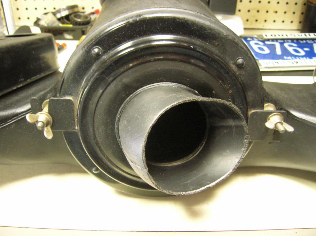

went and took a couple of shots of the air box off my 914-6
my snorkel was cut off (by a PO) long time ago...wish I could find one..anyone have one for sale??
you can see the holes for the cold start arrangement...they are plugged up right now
with plastic hole plugs....it has metal studs, washers, and wing nuts for the snorkel and metal breather hose inlet...
John

QUOTE(johnhora @ Nov 4 2013, 01:18 PM) *
Steve...
John
Jhoyas air filter is the one.
The wing nuts,studs, plastic holders etc. are the same as the four sixes that I've owned.
The cold start plumbing is missing. No need to collect those parts too soon. If you do find them don't dare connect them. Can you say "KABOOM" ?

johnhora   Steve... went and took a couple of shots of the ai...   Nov 4 2013, 12:18 PM
rgalla9146   Steve... went and took a couple of shots of the a...   Nov 4 2013, 05:52 PM
