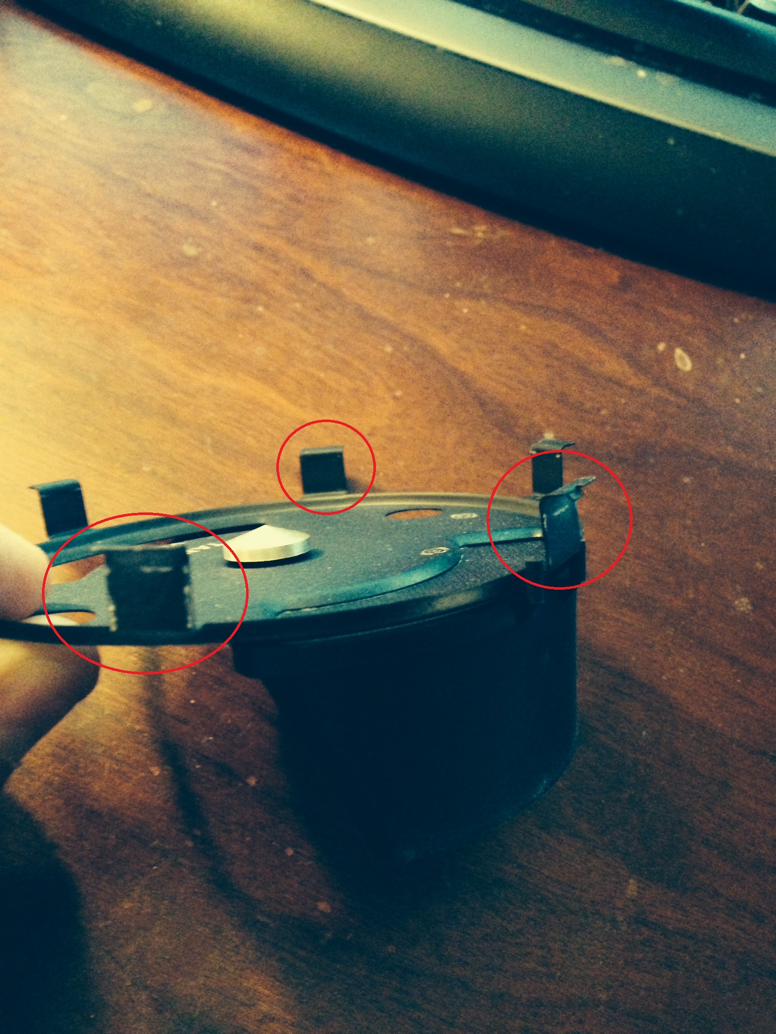

It seems that a lot of the triple gauge business involves making new holes in the back of the can. I figured I could do that. Especially after watching the threads here over and over. Thanks to all.
My problem was the gauge face. I di not want a simple cut out for the gauges. I wanted it embossed in like stock. So here is what I came up with.
The dies fit in my old cast iron hydraulic press. You can see the bottom plate in the photo. I am having some tears, but generally they are about at the cut out line (IMG:style_emoticons/default/biggrin.gif) so maybe they are OK. I found that even with some silversmithing under my belt, I cannot do this by hand. The press makes it flat and even. A coat of high build primer, sanding for flat and trimming and a coat of satin black and I am done I think. Then I need to do some wiring.
BTW, I am looking for some balled up otherwise useless harness wires so I can match the wire colors.

Is there enough material to fold some tabs over?

peteyd   have you tried annealing the aluminum first? It sh...   Nov 5 2013, 11:16 AM
914forme   Way to improve on our original design. :headbang...   Nov 5 2013, 11:18 AM
Mblizzard   Are you using any lubricant while pressing. That ...   Nov 5 2013, 11:26 AM

nsr-jamie   We use very thin vinly plastic in the presses here...   Nov 5 2013, 09:50 PM
