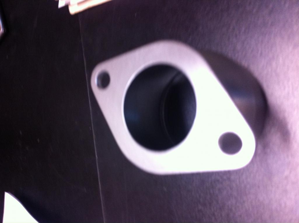

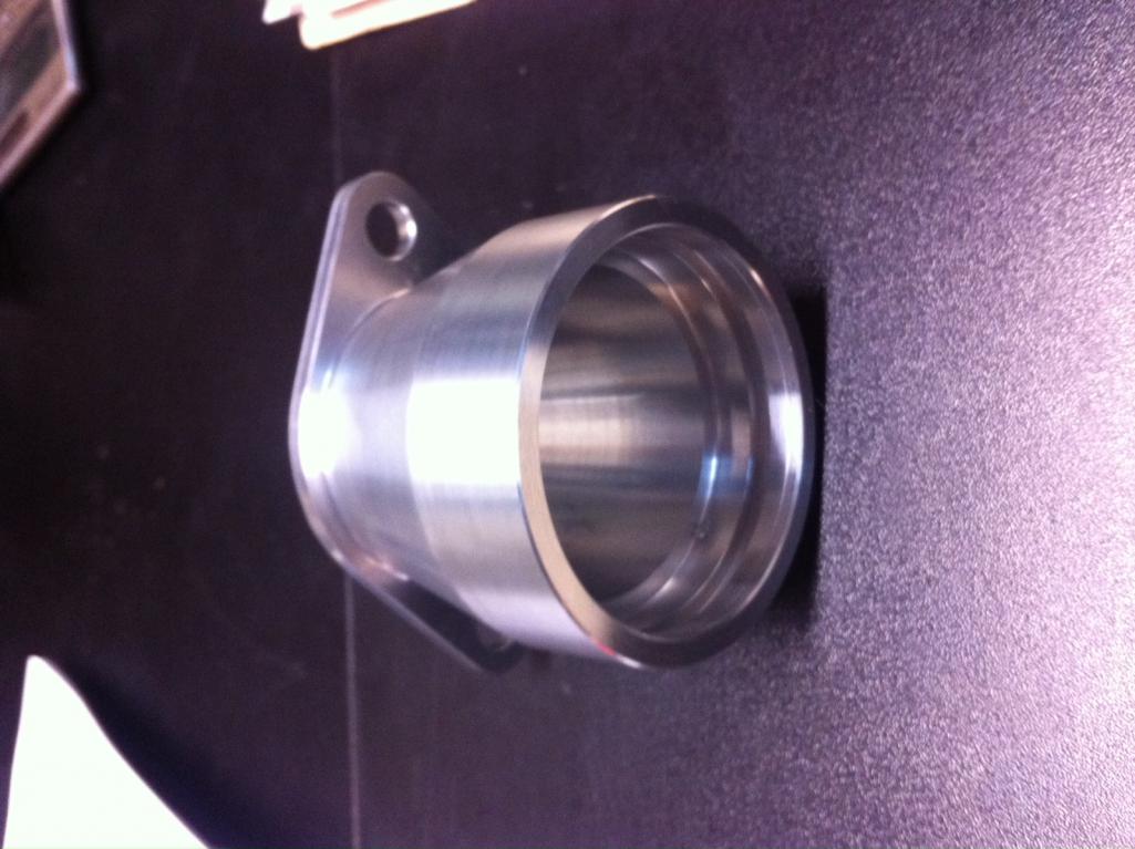

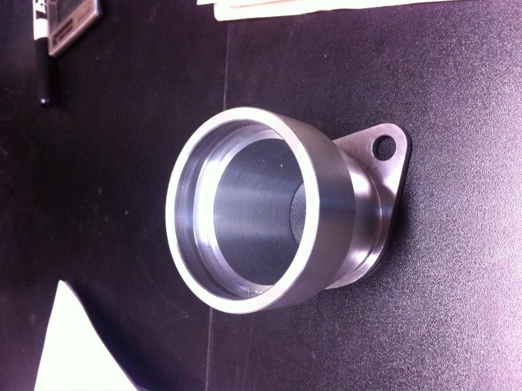

Wow, looks great. Perfect timing, cause I just got pics from the machine shop. Mine are done in machining. Next, a quick hard-coat anodizing. (IMG:style_emoticons/default/boldblue.gif)

McMark   Here's my adapters. Got a sample piece in bar...   Nov 18 2013, 12:13 PM
