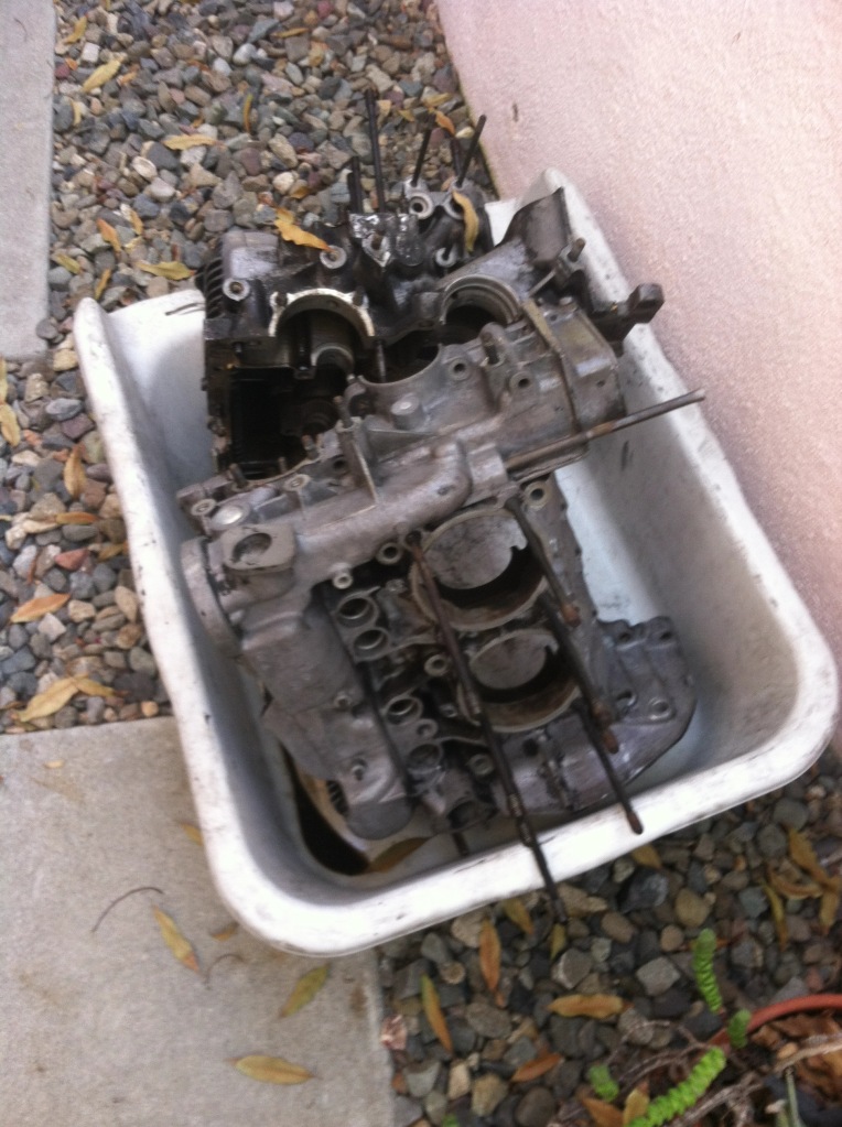

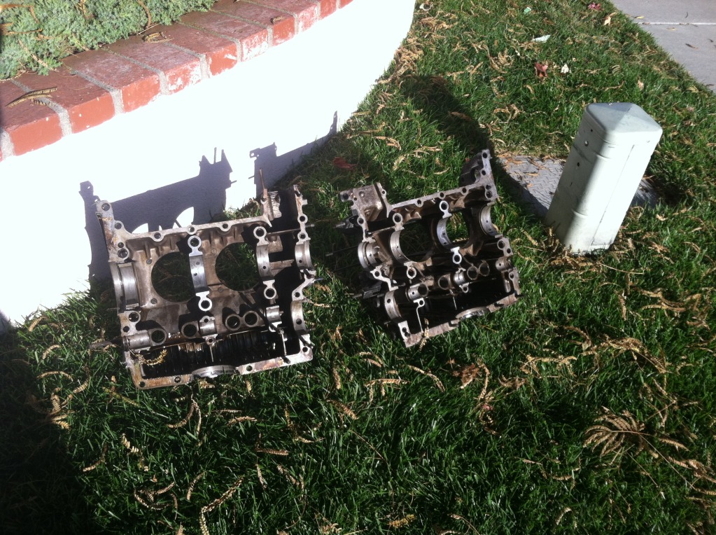

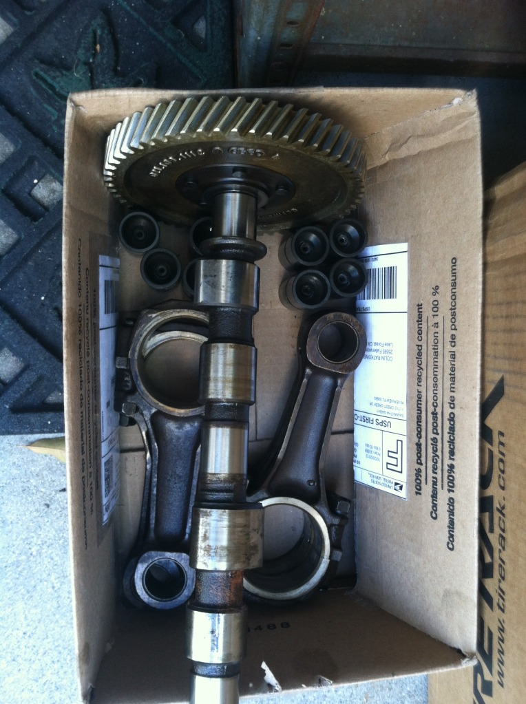

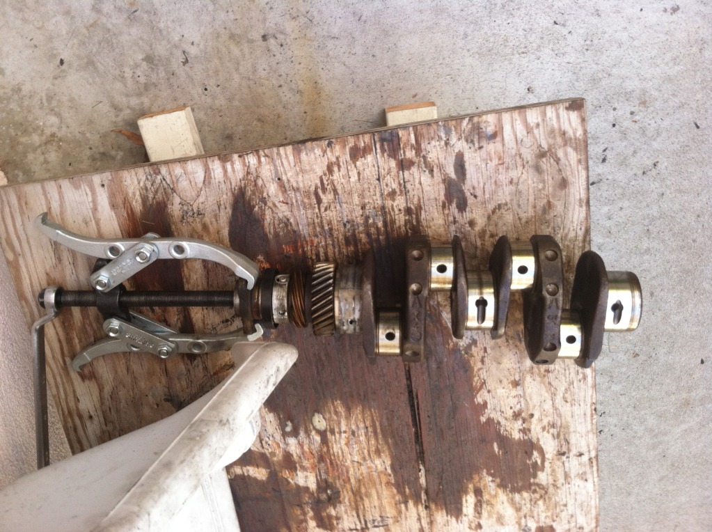

Took my motor apart.
Its bad news folks.
I found a few quarts of water in the case.
and that the lifters were showing signs of going away.
the rods even have rust on them.
I was considering going to a crank with counter weights and if im going to bother to do that why not add some stroke to it right?
anything i should know.
from what i have gathered i need to either do new pistons with a type 1 22mm piston and run those rods or
get arp rods for my 2.0L rods
My dad worked in a machine shop in college and says I cannot bore the stock cyls i have to 96mm i would need new cyls also.
and ill have to pick out a cam but ill probably just call engle and ask them what they think.
