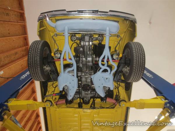

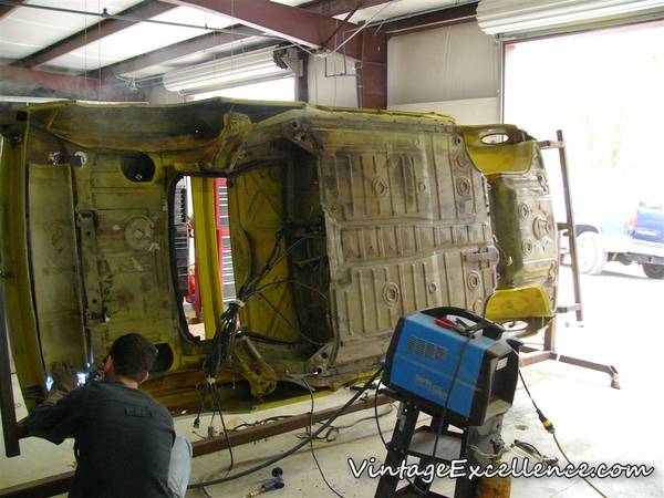

I just stumbled on these photos so I thought I'd share here.
The "in progress" photo actually looks like a pretty good shot of what the factory coating should look like (white/grey in the middle areas), but then it was "over restored" to yellow everywhere. Is that right?
-Steve

siverson   I just stumbled on these photos so I thought I...   Nov 11 2013, 07:31 PM
McMark   Yellow everywhere is right, except just a dusting....   Nov 11 2013, 07:32 PM
siverson   The yellow car is this one: http://www.ebay.com/i...   Nov 11 2013, 07:33 PM
siverson   And to add my opinion - I really don't mind th...   Nov 11 2013, 07:41 PM
