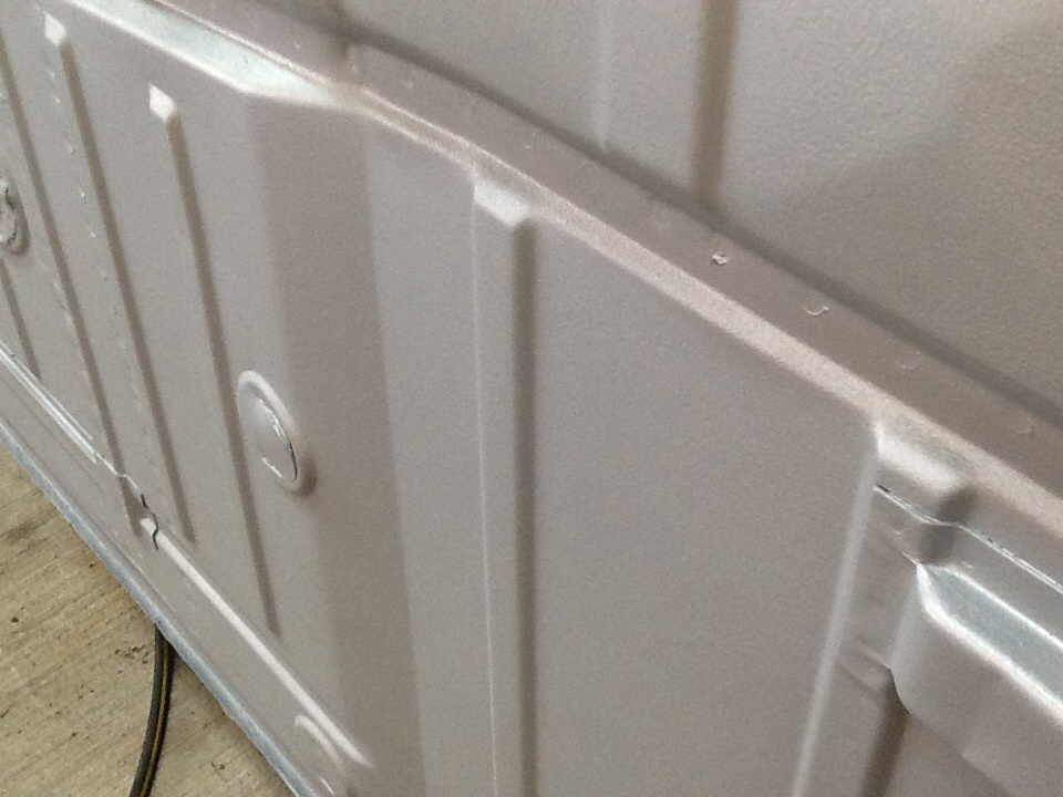

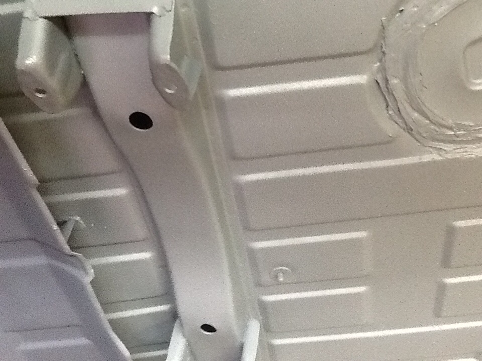

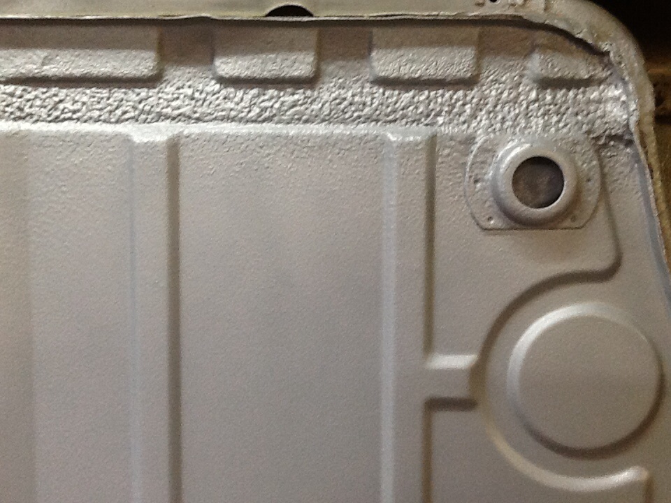

I agree, after cleaning off the black underside of my 72 - 4, this is what I found.
Underside:
Wheel housing:
Floor pan:
Under body:
Paint close And the dove gray primer:
Seam sealer

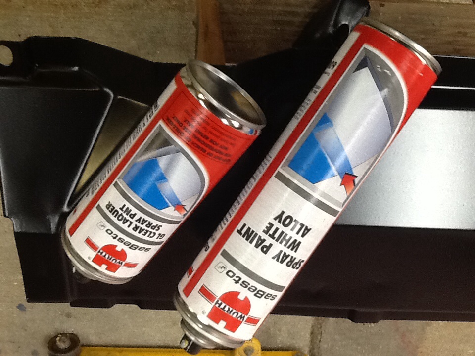

It's not a 6 but here is what I went with. Wurth white alloy, Wurth clear lacquer.
