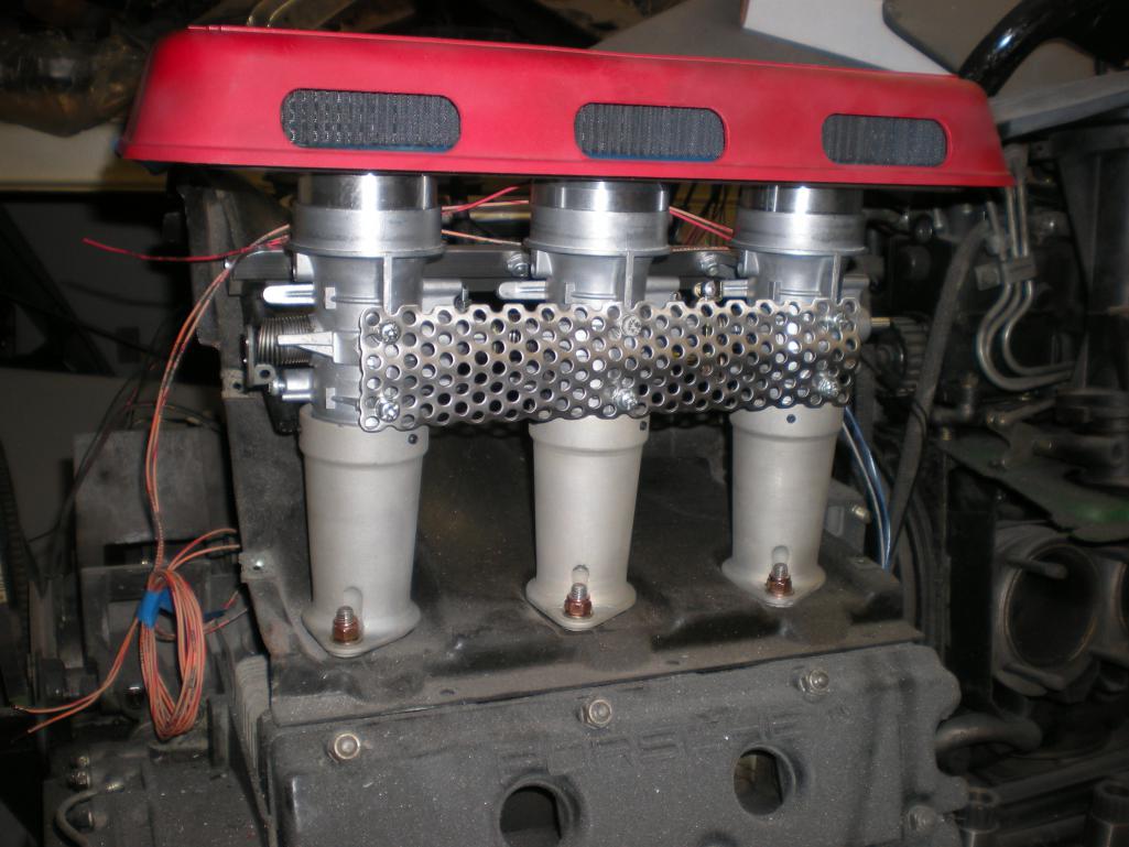

Dave_Darling   It looks cool, but what's the perforated metal...   Nov 17 2013, 10:48 PM
McMark   Those are Jeffs, but it's a mount. It ties th...   Nov 17 2013, 11:07 PM
ConeDodger   Those are Jeffs, but it's a mount. It ties t...   Nov 18 2013, 10:04 AM
sixnotfour   Those are Jeffs, but it's a mount. It ties ...   Nov 18 2013, 02:43 PM
